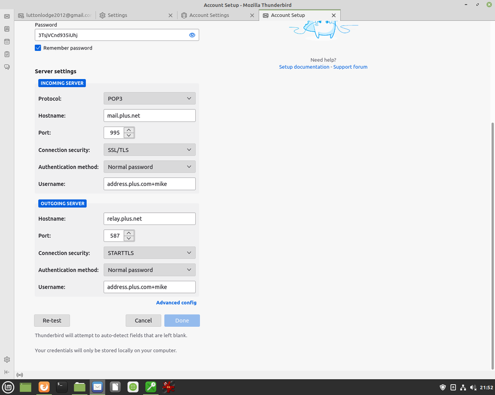

I have been using plus net  accounts on Thunderbird for many years and on different machines. Currently I am using Linux Mint.
I have three email accounts set up on plus net.
  1. Is the postmaster account home@address.plus.com
  2. the main account to use     mike@address.plus.com
  3. third is my partners            jolene@address.plus.com
The first account I have had no problems setting up, following the guide
How to set up Plusnet email - what settings to use
That account works fine but the second and third accounts will not work using those settings. Having set them up on quite a few machines over the years, I remember having to indicate by adding something in one of the boxes (during the set up) This information was included by instructions provided by Plus Net, in a table.
It was something like [home@address.plus.com +mike].
I expected to get this information from the set up instructions. I have contacted the helpers by phone but them obviously didn't understand what I  was talking about.
If you understand what I am talking about please let me know.

  I have read all of your messages and I have tried the settings which I think you suggested I use. The above settings still don't work. Can you suggest where I am going wrong.
Posts: 28,679
Thanks: 12,892
Fixes: 240
Re: Trouble setting up my plusnet emails accounts
The user name should be address+mike
Posts: 23,716
Thanks: 8,423
Fixes: 357
And, if that is how you are actually attempting to set it up, the 'address'  bit should be your actual account name.
