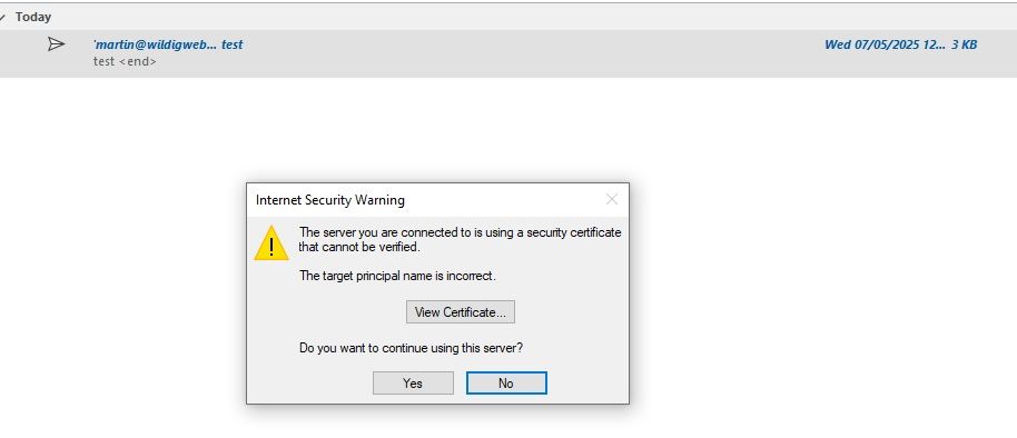

I have a domain name hosted at Free-Online (Plusnet) and in the past couple of days an error has appeared when trying to send emails using it. It's worked fine previously.
I use Outlook and the error message I get is "The server you are connected to is using a security certifcate that cannot be verified"
The emails don't get sent and just sit in the Outbox.
I have some other domains (hosted elsewhere) and they're working fine.
I've done a test using Webmail on Plusnet and when I send from there it seems to work (but I think that's using the original free-online email address rather than the domain one).
I'm attaching a screen shot of the error message I get.
Any help or advice gratefully received, thanks.internet security error sending from martin at martin wildig dot com.jpg

what are you using for the outgoing server name ?

Re: The server you are connected to is using a security certifcate that cannot be verified
Wrong server name: it should be relay.free-online.net
Also port 465 is deprecated; it should be port 587 with STARTTLS encryption.
No, for free-online mail users, that has always been the smtp server address.
Similar for PlusNet mail users, it is relay.plus.net not smtp.plus.net.
Either might work, but they are not all named in the certificate's validity list.
Has the server name changed over the past few days? It's been working fine until then.
The server name hasnt changed but the proxy has been changed.

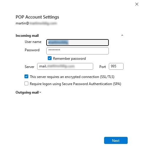

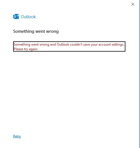

That's still not worked. I'm attaching a screen dump of my Incoming Server settings and error message I get when I click "Next".
The blurred out parts are my domain name, which I registered when I first set up my Free-Online account. It's still hosted there.
I'm not using Gmail. I'error message.jpgPOP3 account settngs.jpgm using Outlook on a desktop.
Posts: 28,979
Thanks: 13,171
Fixes: 244
There is no need to obscure the POP3 server name. Is it mail.free-online.net?
Are you on or off the Plusnet network?
Is this the primary email account or a secondary?
Are you logging on using the email address or account name?

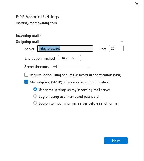

Here are my current outgoing settings (see above)current settings 09 05 25.jpg
I created a martinwildig.com domain name many years ago when I first signed up to Free-Online. This email address is the one I use for everything, presumably it's the primary email account.
Below is my current incoming mail settings. I notice the server is based on my domain name.
I'm not sure whether I need to use relay.plus.net or have my domain name as the server name? Also what port number should I use?
Posts: 28,979
Thanks: 13,171
Fixes: 244
For POP3 the server is mail.plus.net - Port 955.

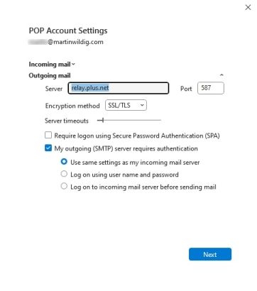

I've received some emails which suggests that incoming is working, but outgoing still brings up and error box.
Posts: 28,979
Thanks: 13,171
Fixes: 244
What error?
SMTP port should be 587 as per the guide I pointed you to. Go run the Plusnet diagnostics.
Are you on the Plusnet network or connected by some other means?
Posts: 20,010
Thanks: 8,980
Fixes: 579
@MWildig you previously had the correct port 587 for the outgoing server but the wrong encryption SSL/TLS. Now you have the correct encryption STARTTLS but the wrong port 25. Change the port back to 587 but leave the encryption as STARTTLS
