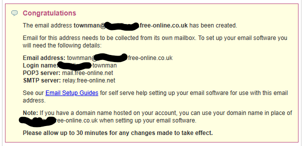

At the time of posting, be assured that for secondary mailboxes on Free-online the login userID (for SMTP and POP3) would be fred+bill or fred+jo whereas fred@fred.free-online.co.uk will work as you are finding out.  There is however an 'aberration' in that secondary email address login will work for the IMAP server.
I'm running tests across all of the brands and can give you chapter and verse on what does and does not work.  The userID (login name) is clearly indicated on the mail box setup confirmation page as the preferred credentials ...
The diagnostics below verify that on a secondary mailbox, using the email address as the credential does not work consistently.

Whereas account+mailbox does work...
curl.exe -v pop3s://mail.free-online.net -u ******+townman
Enter host password for user '******+townman':

Thanks for your detailed response. That resolves the issue.
Note that at this time secondary email addresses can successfully be used for login on the SMTP server providing the password is the same as for the primary account. (As the primary and secondary email accounts are all used by one person, one password for all is suffcient.)
Tags (1)
Posts: 28,225
Thanks: 12,629
Fixes: 237
Re: Settings for Free-Online relay.free-online.net mail server no longer working
Errrmm ... only if you are connected to the Plusnet network.  If not, they do not work.
That is why ON NETWORK email address for secondary mailboxes appears to work for an IMAP client, but will certainly not work for SMTP when off network.
accountname / accountname+mailbox will always work whatever the connection for all free-online mailboxes.
