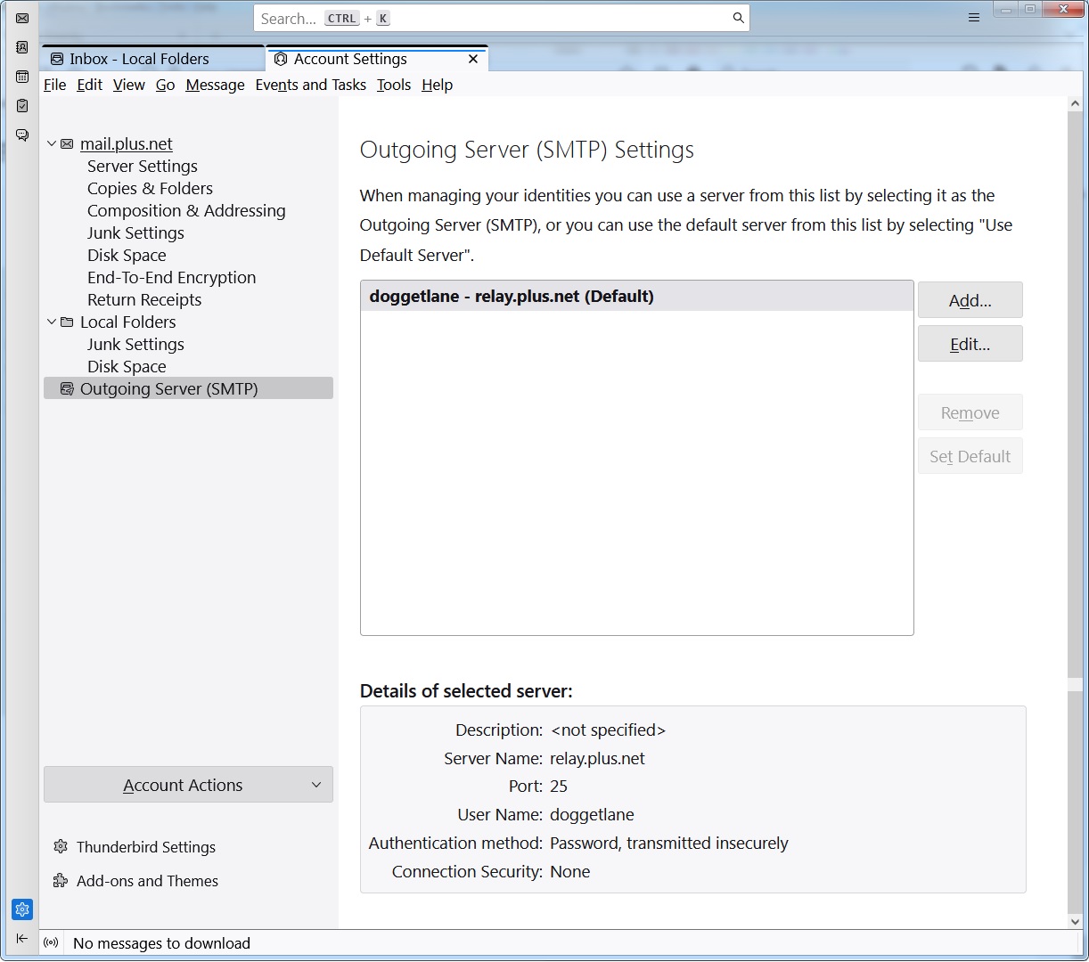

Thanks for responding @mavison
See attached screenshot. I thought about including this in my post. Wish I had now 🙂.
The character in my original password - that I've used with Plusnet ever since I joined - was Dollar $. I replaced it with another non-alphanumeric character which has obviously been accepted by the incoming mail server.

@Buggwrit Your screenshot shows that the Port, Authentication and Connection Security are not ideal or even plain wrong (even though the Greenby bot may have suggested them!).
I suggest you ...
- Select Add from that screen
- Enter Description: Force9 Greenby
- Enter Server Name: smtp.force9.net
- Enter Port: 587
- Select Connection Security: StartTLS
- Select Autrhentication: Normal Password
- Enter User Name: <your account name>
- Click OK
- Select Force9 Greenby in the list of servers
- Check values are correct at the bottom
- Click Test Connection to Server
- If Successful, click on Make Default, then to send email.
- If fails, post messages here.

@Buggwrit They may have worked with Plusnet email ... but they were not ones that have been recommended by PN for many years. Times move on, and I would not accept my emails not being encrypted these days, which would have been the case with your settings.
I deliberately did not suggest changing your existing server settings, but if one works better than the other you could delete the worst one.
It will ask for your password again - make sure it is the current valid one for your Greenby main account.

It's still not working. Although I've changed the SMTP server settings it still seems to be trying to use relay.plus.net. I removed the SMTP entry from the saved logins list then tried to send a message. It asked for a password which I entered correctly after which it came back with the same error indicating it was using relay.plus.net and that reinstated the original entry in saved logins.

@Buggwrit Apologies - the outgoing server should be relay.force9.net.

Ah, that's more like it 😊. We have success.
I discovered that the reason it was still trying to use relay.plus.net was because I needed to select relay.force9.net as the Outgoing Server in the Account Settings for mail.plus.net.
