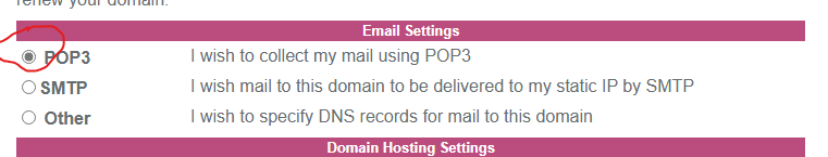

  2. Check the email delivery settings - login in to the portal -> Manage Account -> Manage your domains -> Email set to collect using POP3

[FWIW the POP3 email setting is still set correctly.]
