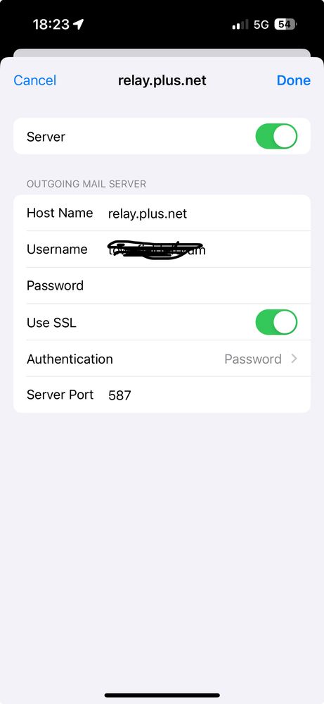

Basically as previously advised, your need to configure authenication on the outgoing(smtp) server using your plusnet credentials
For completeness
Host Name - relay.plus.net
User Name  - your plusnet account name
Password - your account password
Authentication - Password
Server Port - 587
and if there's an SSL/TLS box then check it

This is what the smtp settings should be on an iPhone…
Username should be accountname+mailboxname
