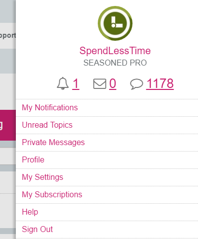

Seen this a few times today, when using the slide out menu.
The Bell symbol has a non zero notification count but the menu option "My Notifications" does not. So the code to build the slide menu seems to be retrieving the notification count multiple times and then building the menu using 2 sources for the same item.
Not a biggy but a visual annoyance.

If it happens to you again, can you grab me a screenshot of exactly what you are talking about? It hasn't happened in a while to me but I am curious to see what you guys see so we can pass the feedback over to lithium about it.
Re: New visual anomaly on slide out menu
20-07-2016 4:27 PM
So one notification identified to the right of the Bell symbol but the menu item does not have a number against it. I would have expected it to read "My Notifications (1)" as I have seen it say "My Notifications (3)" today when the top line value was 3 which implies that the number should be added to the menu item for any non zero value.
20-07-2016 4:34 PM - edited 20-07-2016 4:35 PM
Ah right, okay.. so what you are seeing is a customisation of my own here. The 'my notifications' and 'private messages' parts are actually my own custom modules I created and crow barred into the user menu that was built by lithium. They do not have access to the ajax request that happens when the menu is clicked and the top row is updated. The number on the 'my notifications' and 'private messages' are driven by requesting the API on page load and do not update.
I might be able to write some javascript that would update those numbers on the user menu being clicked but I have a feeling it would be more complicated than simply taking the number (that updates after the click) and placing it in those items. You will see that the useful links bar at the bottom does the same as they also do not have access to the ajax request.
So this is actually working as expected. Those two items are my own customisation to the existing system (that I do not have full access to). I am not entirely sure if I can change this tbh.

This is my custom components for 'my notifications' and 'private messages' not updating the numbers via ajax when the user menu is clicked. My components use the API to get those numbers and not the same code that is used to update the numbers on the top row.
Edit: I have posted on the Lithium developer network to see if I am able to access the ajax request in a similar way for my customisation of the menu. Fingers crossed I get an answer soon otherwise I am going to have to do a little bit of tinkering.

It can happen if you clear your notifications and open the user menu on another tab. When you open the usermenu again the number will still be there on my custom sections if you haven't refreshed the page.
This was functionality that was requested by some of the forum members that have access to the stage site and I met them halfway with what you see now as I couldn't get that ajax request to work on my menu items I created.
I will put a pin in it for now. I have posted on the developer network about it. If they have a solution I will see if I can implement at some point but I have a feeling there isn't a way to do this so it might need a bit of javascript cloning to happen.
