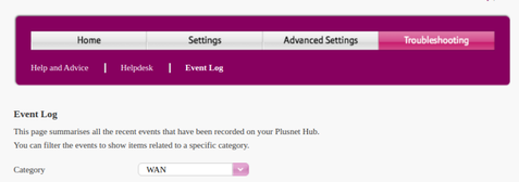

If you posted the Help Desk info as requested then we can see what has changed.
Are you sure the Hub One is rebooting or is it actually just dropping the DSL connection?
Can you capture the event log for the time of the failure then it can be determined if this is a reboot or just a DSL resync
From the Hub One landing screen >Troubleshooting >Event Log >Click category and select WAN.

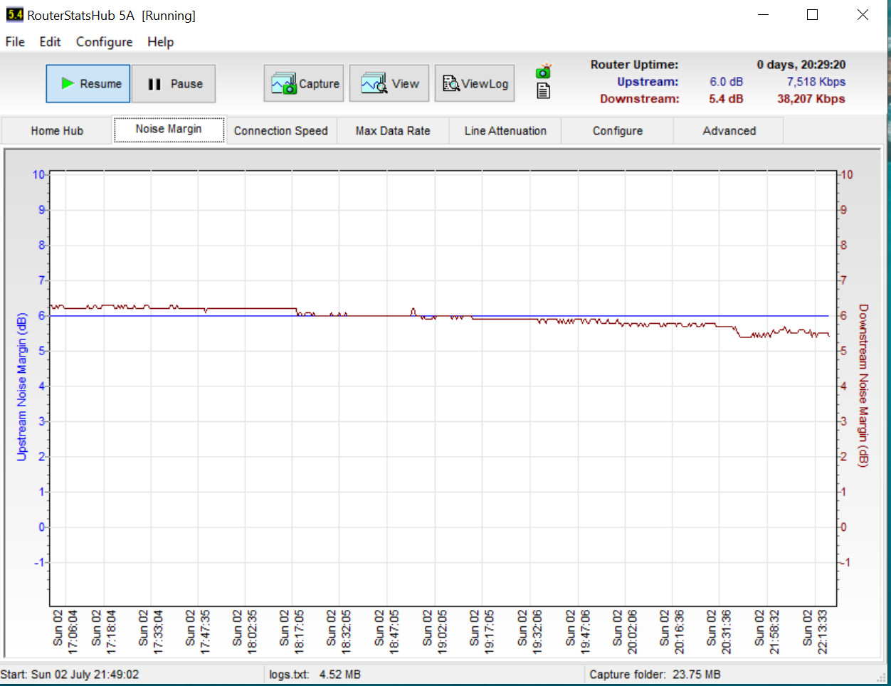

forgot to add that, as i said, downstream snr started at 7.7db yesterday and after the 2am reboot, it dropped to just over 6. as it is atm, according to routerstatslite, it's down to 5.5db. as i have said previously, this drop happens every evening but it doesn't always start next day or go back next day to where it needs to be at 6+db. whatever causes the snr to fall away seems to be a problem but, in my opinion, when the router reboots or the connection drops, as Dan_the_Van suggests, the downstream snr always seems to drop too low. that then causes the further evening snr drops that dont improve sufficiently the next day until eventually, the snr drops too low and a reboot/connection loss happens and away we go again! this has been going on seemingly forever, regardless of what O/S i was using and what machine i was using.
Re: using my own TP-Link 2100 router
02-07-2023 10:31 PM
dont know if this screenshot from routerstatslite, like the others i posted, is any help but thought i'd add it anyway. it shows how the downstream snr is/has dropped. wish i knew why. note when the drop started, ie, no boiler on, no street lights come on, my tv, speaker bar and freesat box been on since 14:30. microwave used once from 14:30ish for under 5mins. i'm at a loss

From a technical point of view a reboot is a stop/start of a device, with the Hub One unless you see a green light on the device during the sequence of change it has not rebooted.
01:48:05, 02 Jul. (1861829.110000) PPP LCP Send Termination Request [User request] - Link Control Protocol
01:48:08, 02 Jul. (1861832.170000) PTM over DSL is down after 2209 minutes uptime
01:48:08, 02 Jul. (1861832.170000) at this point the Hub system uptime is around 21 days 12 hours (1861832 seconds)
DSL is down after 2209 minutes uptime this is around 36 hours
What is occurring are DSL restarts. Repeated reboots would be investigated differently.
NB
The router uptime on the RouterStats app is the DSL uptime not system uptime
Don't forget to change the sampling to every 10 seconds with 720 plotted points.
HTH
