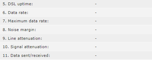

30-06-2023 7:23 PM
this is the info from in the Hub one. hope it's what you need. i thought you was after info from routerstatslite, so no wonder i couldn't find/didn't understand. if there's anything else, i'll try to post it. however, as you can see, things are a little different since the router reset
info asked for:
5. DSL uptime: 0 days, 06:17:12
6. Data rate: 7402 / 39993
7. Maximum data rate: 7486 / 42814
8. Noise margin: 6.1 / 7.4
9. Line attenuation: 38.0 / 22.7
10. Signal attenuation: 37.0 / 20.1
11. Data sent/received: 9.6 GB / 177.3 GB
Re: using my own TP-Link 2100 router
30-06-2023 8:53 PM
Those router stats suggest that the line is being “managed”. SNRM of 7.4dB is neither 6dB or 9dB which would be a standard value.
