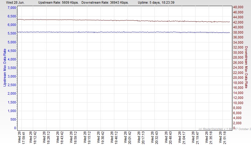

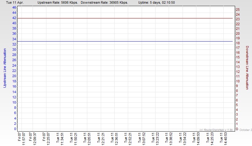

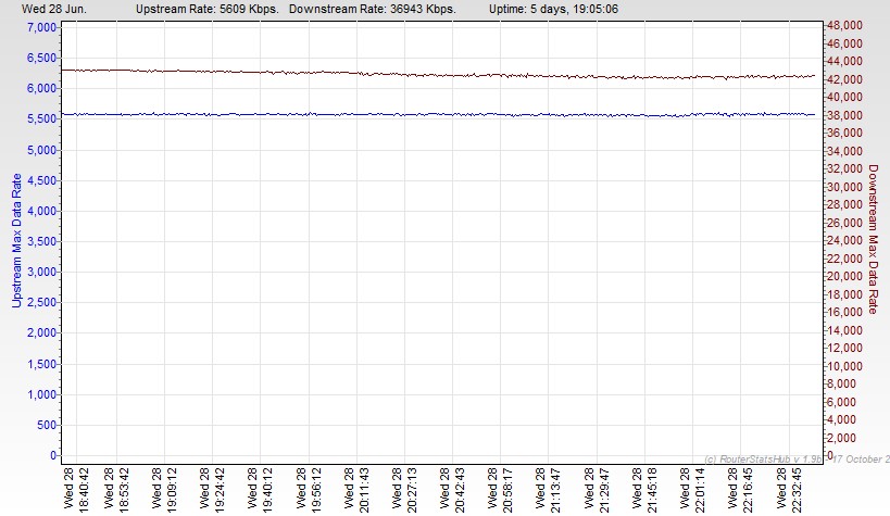

Please post samples of the SNRM graph which looks anything other than clean.
Line stats from the router - as requested before - would be helpful as well.
Re: using my own TP-Link 2100 router
29-06-2023 2:49 PM
ok. i'm gonna try to attach some bits for you to look at. i have no idea on the upload limit, so i'll see what happens. if i have to do multiple uploads, understand why i've had to do so

4th post with attachments. please bear in mind, that there has been no router reboot in over 6 days, so the only change you'll be able to see is how the downstream snr drops from whatever it was (6-6.1db) around 10 or 11 am to maybe as low as 5.4db. once the downstream snr starts to fall, over a period of 2-3 days maybe, it will fall further until there is a router reboot, the downstream snr goes up to whatever level it deems needed, the downstream speed will reduce usually by 3.5mbps and away we go again. if that doesn't fix the problem, even though plusnet ALWAYS says it cant see any problems, the snr will keep going up and the speed falls away until it is admitted there is a problem and openreach are contacted. they ALWAYS find issues, usually more than one and the engineer often has increase the time spent eliminating the extra faults found. not good for the engineer, not good for the customer, me and not good for plusnet. this has been the continuing cycle for a long, long time!
