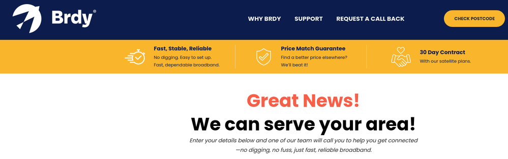

The other option available to @stathe that hasn't been discussed so far, is satellite broadband, which given @stathe 's relatively remote location, might be worth investigating, as broadband and mobile operators are unlikely to be in any hurry to upgrade that sparsely populated area to give anything better than minimal coverage.
For example, Brdy - https://brdy.com/uk/
offers -
Screenshot 2025-09-15 at 09-51-39 Satellite Broadband UK Brdy Starting from £29.90.png
... and putting @stathe 's postcode in to their availability checker says -
