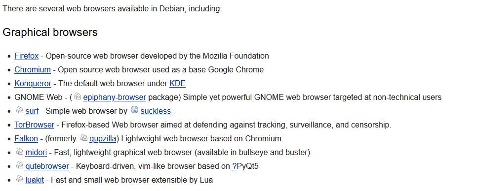

It is a setting in the Firefox browser, if you are using Firefox. (about:preferences#privacy)
Most configured mobile devices won't be using Firefox as a browser (unless the browser has been changed/updated). You reported that using your mobile device didn't have the same symptoms.
Firefox may come as a browser as part of *ix installs.
Just a thought/opinion. Your DIG appears to be a Debian install.

@greygit1 no, firefox doesn't have DoH enabled.
Everything connected through the router and Plusnet is affected - all browsers, i.e. Google Chrome, Firefox, Chromium, Edge on all OSes i.e. Windows, Android, Debian, Mint, Raspbian
The phones don't work on the Akamai websites when connected over WiFi to the router and Plusnet. They work fine when WiFi is turned off and they use mobile data instead.
(The Debian boxes are headless, so they generally don't have browsers installed.)
