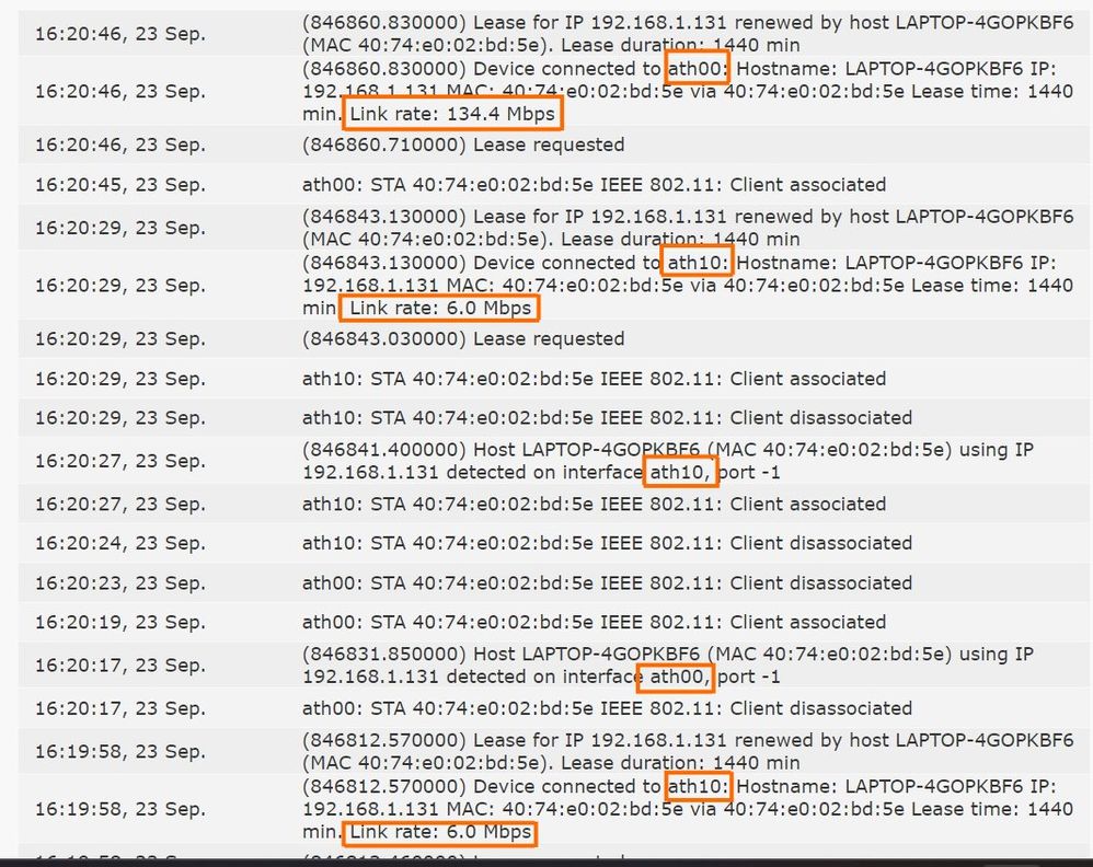

Re: getting lots of short wifi drops that are not resetting the hub
this is a screen shot of my most recent disconnect event.
From that, it appears your laptop is for some reason being unable to hold on to the lease. I'm not an expert on networking, so I'm not going to claim I am correct here.
Looks like the laptop is toggling between the 5 GHz (I assume radio ath00) and 2.4 GHz (I assume radio ath01) channels.
See Highlights:WIFI dropout.jpg
5 GHz WiFi is usually faster but shorter range. It does not travel through walls, floors or Windows as well as 2.4 GHz.
Whilst 2.4 GHz can travel further it is more prone to interference from neighbours WiFi (as the neighbours WiFi can travel further) and other RF signals in the 2.4 GHz band such as Microwave ovens, baby monitors, video senders and smart meter zigbee signals etc....
As the 2.4 GHz signal is only maintaining a 6 Mbps link it would suggest interference from other RF signals.
ath00 is 2.4Ghz, ath10 is 5Ghz
so the slow speed would suggest a week 5Ghz signal.
Try splitting the wireless name for the 5Ghz signal by adding -5 to the end.
Thanks, @RichardB . As I said, I'm no expert, and I admit I hadn't spotted the toggling. As I assume the laptop isn't physically moving (?), what could cause that?
The toggling will be either be due to a weak signal or interference.
@Dan_the_Van advises that my assumption on which radio is the 5GHZ and the 2.4 GHz was back to front.
As such is the 5Ghz that can only support a 6 Mbps link speed.
Unless @iwbrock lives in close proximity to Neighbours (maybe flats) that indicates a weak signal.
I wonder how far apart the router and laptop are - different floors of a house?
A WiFi analyser image for both bans might be informative.
@RichardB
The Hub One does suffer from the toggling between signals.
Some devices attempt to maintain a 5Ghz signal if it sees one, hence the toggling
The thinking behind splitting the wireless name, then the user chooses the strongest signal.
Edit: a Hub Two does not have this issue.
@Dan_the_Van
Very true, but this makes me also wonder whether it's the hub going on the blink
@iwbrock wrote:
... its happening to all devices including when connected by ethernet
Perhaps it's time to ask for a Hub 2 to try.
