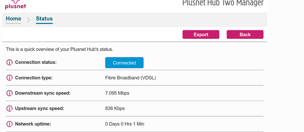

Re: connection speed dropped from 35Mbps to 6Mbps way below 16Mbps Speed guarantee
Hi Thanks,
I have already gone through the troubleshooting steps, The line is synced to 6 ish Mbps and this (if Im correct) would indicate problem with the line? any thoughts
The easiest way to tell would be a quick call to 17070 option 2 - is the line quiet?
But your uptime of 1 min does not look good.
Have you reported a fault or used the system to check your line?
the uptime is short because I have tested spare router.

Screenshot%20at%202023-03-29%2022-58-54crop2
@JohnDoe
I don't know if you realise, but from the info above you actually have FTTP (i.e. full fibre) available to you should you wish to upgrade.  However, as things stand at the moment, unless you jump through some hoops there is no simple way of retaining your phone number by porting it to a VoIP provider without running two parallel services for a short time while the changeover takes place (FTTP and FTTC).

@JohnDoe - Thanks for PM'ing me, there is a Major Service Outage in your area which is currently being worked on. There is an estimated fix due on the 05/04/2023 17:57:00 but please keep in mind that this is only estimated and could be quicker but could also take longer to fix. There's a ticket open with our faults team so they'll be keeping you up to date.
Currently with your Full Fibre order, we're planning on getting you installed on the 02/05/23. There is some external work first of all to get the infrastructure ready so when this is fully completed you'll receive an email to confirm the installation date. I'd estimate you'll have this confirmed 5 working days from when your order was placed so sometime Friday.
