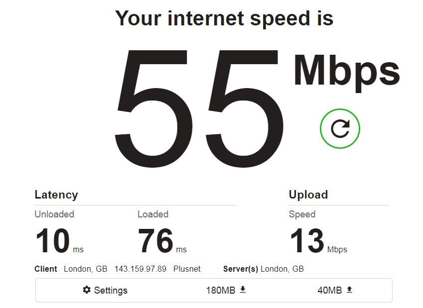

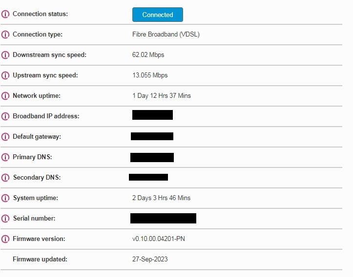

23-02-2025 3:26 PM
Re: Yet another set of outages and now slow speeds
24-02-2025 10:18 AM
Looking at the at the 'Line attenuation' stats since January when you first posted they look more realistic
January 7.7 / 26.6 last post 11.6 / 19.3 on one post the uplink was shown as 0.0 / 19.7
Have you had anymore DSL disconnects since you last posted?
24-02-2025 7:13 PM
No, the line has been solid and fast since the many outages on Friday morning.
