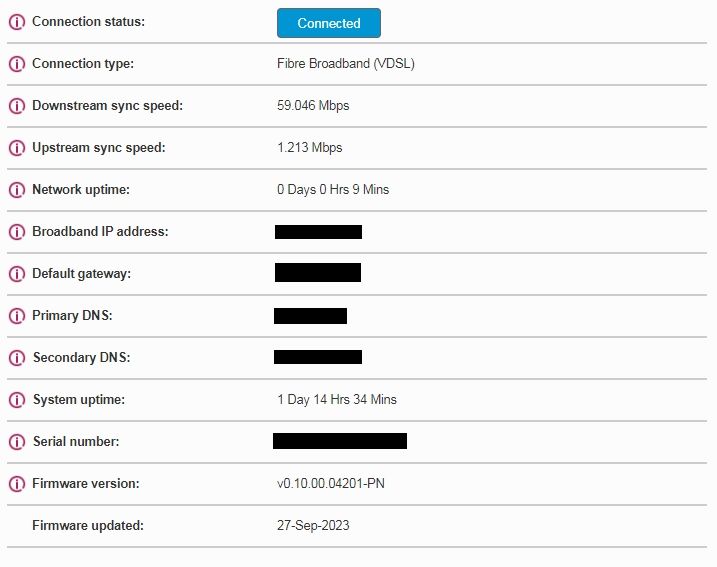

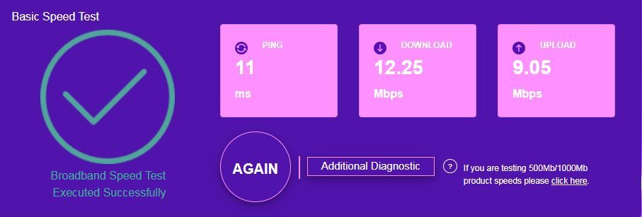

Hi All,
Just had yet another few outages and they seem to keep happening and now my speeds are now very slow (upload is incredibly slow).

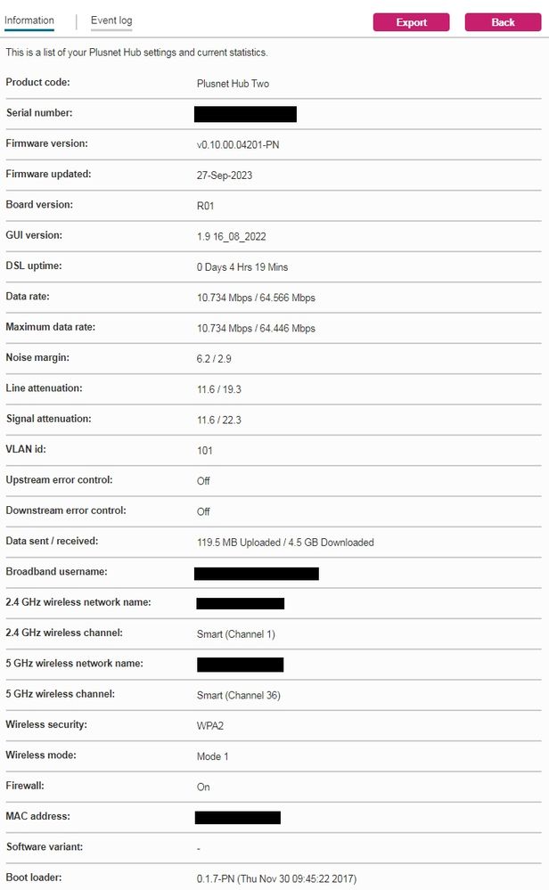

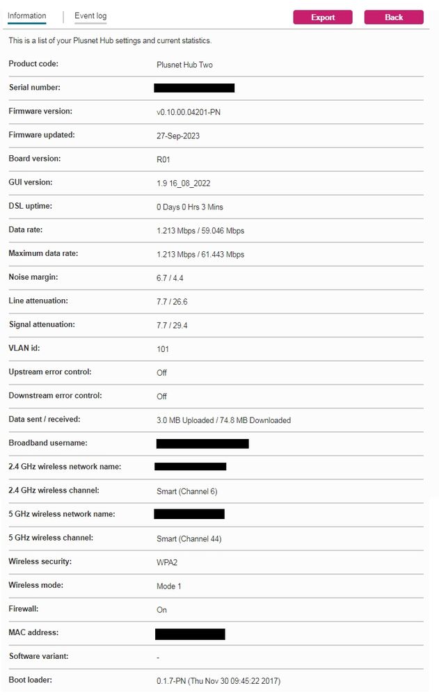

Sharing only part of the router stats is not as helpful as sharing the full set.  Speed figures only make sense in the content of the others.
There is a marked change in upload speed, which will have some impact on speed test reports.  That said one of the more complete reports indicates 0dB SNRM on the upstream which is far from correct.  There is probably still a fault on this line - wind or no wind.  If wind is impacting performance, then that suggests that there are iffy connections requiring attention.

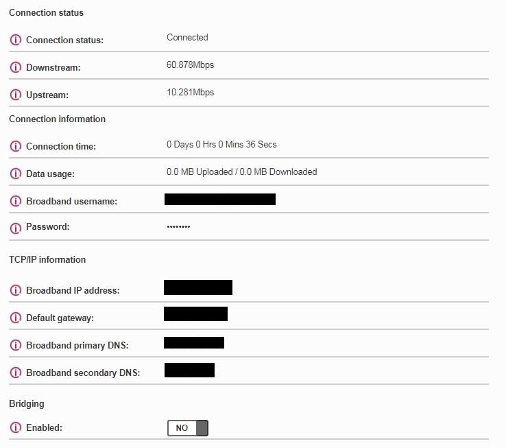

Complete stats.  The last router stats reporting 60/10 omits the associated SNRM and attenuation figures.

You have been posting stats from two different pages of the router admin system.  The "front" status page is not overly helpful (the one with the purple I's in circles); it reports speeds with no context.
What is required are the stats from the TECHNCICAL LOG screen - that provides a context to the speed figures.  You put that in your fist and second posts and they indicate where the issue is.

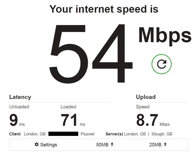

Gotchya. To be honest, all afternoon I have had a perfect service and speeds around 60 Mbps.Pn56.jpg

Please do not disturb the router any more - leave as is powered on and see how long you remain stable.  The speeds have improved with every report you have submitted here.
  • Up stream is now significantly better up at 10.7mbps from 1.2mbps ... but the line attenuation is also up, but that could be associated with using more 'tone bins' (very technical, do not worry!)
  • Down stream is slightly better at 64.5mbps compared to 59mbps - again some change in the line's attenuation and noise margin
Do you have telephone extension wires (they not being used is not relevant)?
Do you have dLAN adapters?
A slow upstream can make a marked difference to downloading.  60mbps DATA speed over 64mbps sync speed is fairly good.  Let us hope it stays that way.  Keep a watch on the router stats (do not bother with data speed tests) - especially note disconnections.
