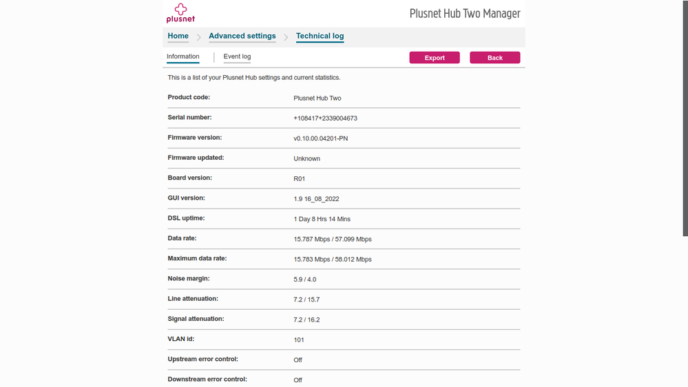

I've just come home from being away for a few days, so haven't managed to call Plusnet to request an Openreach engineer to solve external bridge tap, however, in the meantime, the line seems to have recently re-synced itself to the exact minimum 57mbps download we've been promised by Plusnet (which matches the downstream handback threshold for an impacted line) so I doubt they would involve Openreach now, even though we could possibly achieve approx 73mbps as next door.
However I'll keep an eye on it and request Openreach if it drops below this again. Perhaps the internal wiring must have been having an impact after all - the Qube engineer put a master socket directly behind the router. As I wasn't there for that appt I'm not entirely sure what he did, but I left a note to check for star wiring to exclude possibility of internal bridge tap.

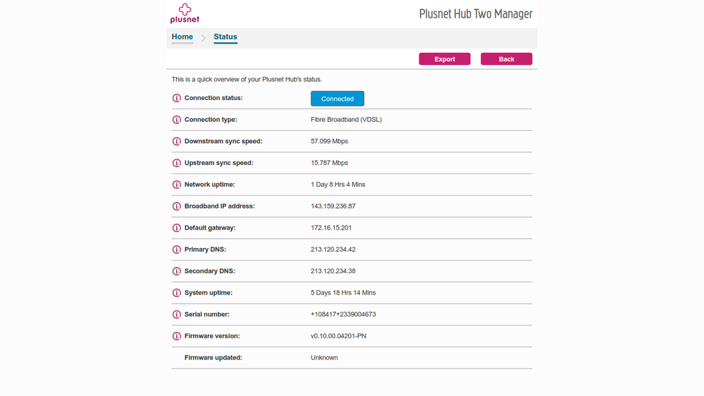

Re: Wrong line profile
Noise margin better than before but noticed a slight creep up from yesterday evening:-
