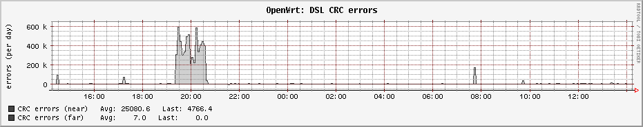

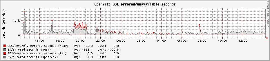

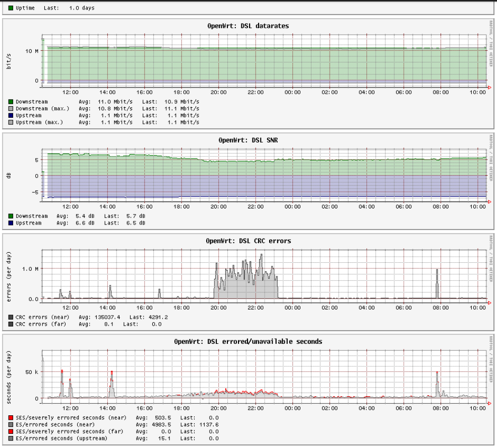

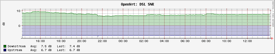

Last 24 hours graphs (The CRC errors are actually recorded by my modem as HEC errors - I just didnt change the graph title/legends!). The error reporting is a bit quirky... its collected once a minute (ish) and it's showing the errors-per-day at any given minute (kinda pro-rated)... so I think where it says a peak of 600k CRC errors... it means 600k/24/60= 416 or 417 HEC errors that minute... or the 10k ES (of course, there are not 10k seconds in a minute - so that would be nonsense!) is more like 10k/24/60 which is a more reasonable 7 ES that minute. I'm not certain though!!
11843e70-6e55-4b68-97ab-cb6751c2e555.pngb67cb200-6c22-427a-af55-f3138d7306f9.png8e034269-20b7-4938-9475-11ff4f86e89d.png0f15985a-c6ee-4346-bc90-7214e401f241.png868c1252-76a5-4c91-86ac-58defd2b868b.png
The average ES has increased a bit... so I don't expect to retain sync for more than a couple of days. Especially after my Plusnet profile changes and I reset the PPP connection to Plusnet.

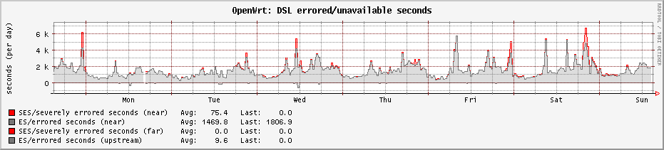

The constant HEC errors above are somewhat masked by the huge peak increasing the scale on the y-axis... so here are the HEC errors (pro rated per-day remember) from the past hour.
I also included the ES for the week so that you can see the trends/patterns. Obviously, ignore scale since the SNRM target is not consistent over the period... but the pattern is still uesful.

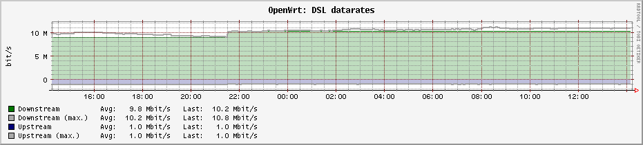

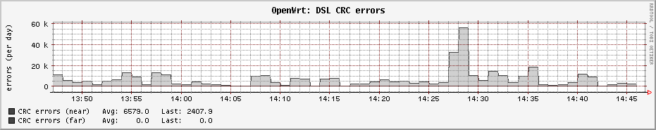

I only just checked the line in the last hour... and found it had been running for about 2 hours at 13.6+Mbps@1.6dB SNRM!! (Obviously my modem was adjusting the SNRM Target)
Heres a quick shot of the stats for the last hour before I reset FYI... the errored seconds are amazing!! 71834 ES per day (pro rated in that hour) out of a possible 86400 seconds in a day!!! How on earth did the modem hold on for 2 hours?? I guess the Plusnet profile would have been limiting me - and that probably helped (or not? I'm not on fixed IP - although my IP never changes... and I'm sure I read somewhere that dynamic IP doesnt use the plusnet profile... or is that just VDSL? I've read so much!).
You can see I removed my SNRM target numbers and reset the connection and will not play with it for the next few weeks or until we give up!
No sign of interleaving (or ReTX!) yet... guessing the line will have to reset a few times before that gets added.

One full day (no resets!!)
There was some gaming between 6-10pm and no complaints at all - despite the huge number of HEC (CRC) errors
5k average ES is pretty high for me.
Usually, when the SNRM breaks 6dB (when throughput is running at 88% of synch) it all goes wrong... but this looks to have held up quite well.
My SQM graphs don't show any problems with latency or congestion or anything either.
I'm guessing a lot of this good behaviour is due to the bRAS/Plusnet profile (Plusnet is still reporting 7.8Mbps... I'm guessing DLM will not move the bRAS due to all of the errors and the "Stable" plan).
Although the line is synching faster I'm not seeing any improvement in throughput at all yet. So the reduction in SNRM is just wasted at this point. I may as well be synching at 8.8Mbps@9dB with fewer errors.

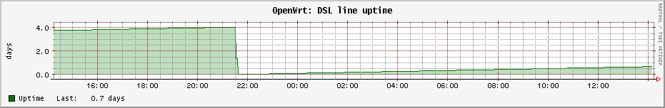

Lost synch today just before 2pm... seems to have come back at same rate, but with Upstream Bitswap not enabled/activated?
Dont think I have noticed that before. Hardly any upstream errors.
No sign of interleaving.
