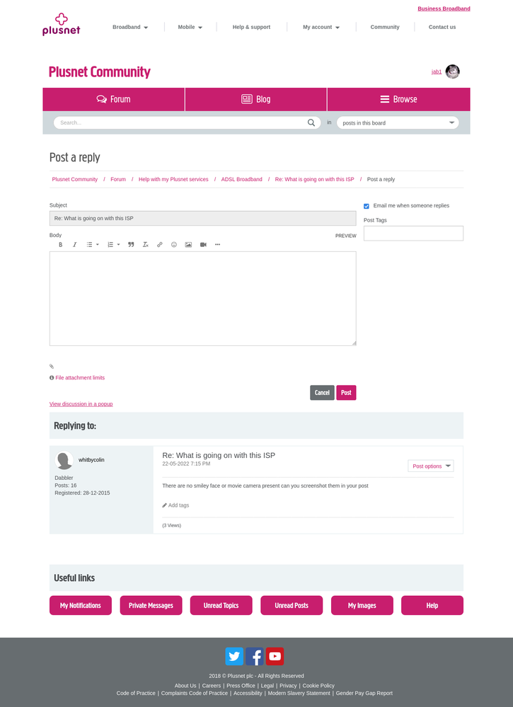

Can't help with most of your post, @whitbycolin , but to insert pictures into a post, click the icon between the 'smiley face' and 'movie camera'.

There are no smiley face or movie camera present can you screenshot them in your post

If you are using a desktop/latop, then this is the compose window, with the icons I mentioned at the top:
