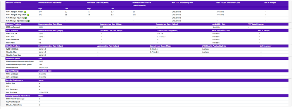

OK, as I suspect there is a  fault, can you start by posting a scree shot of the result from: https://www.broadbandchecker.btwholesale.com/#/ADSL  , assuming you still have a phone line connected, otherwise use: https://www.broadbandchecker.btwholesale.com/#/ADSL/AddressHome

Here you go.

Exchange STOWMARKET is served by Cabinet 24

Thanks for that. You are a loooong way from the cab, so what you are getting is quite probably the best you can, to be honest.

Thanks, how do you know the distance?

It is discernable from the figures at the top left of your screenshot  - with a downstream line rate that low on VDSL, I'm guessing, because I don't have time to search for the calculator which would give a more accurate figure, that you are close to a mile away from the cab, with a resulting long copper run.

@tbutcher your router is estimating the maximum line rate at 27.8Mb. You are synching at 25Mb which is slightly below this and is probably due to being capped at that speed by the DSLAM to stabilise the line.  According to the BT checker results, 25Mb  is above the handback threshold and so getting Openreach to investigate is going to be almost impossible.
As@jab1 says, what you are getting is reasonable for your line length.
