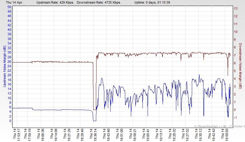

What I seek to identify or rule out is local intermittent interference ... which could give rise to the scenario you have described ... intermittent slow performance.  Bad SNRM plots look like this...
This graph shows variability on both the DS & US - things look fine until 18:30 - then something causes a disconnection after which the (much slower) connection is besieged with REIN.  From 18:30 one would expect rather poor throughput speeds.

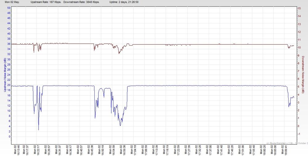

Okay @Townman @TheMightyAJ I'm finally able to get back on this.
I was able to leave the router stats running for a few days to cover the days most likely to experience the problem. Everything seems normal in the charts. Just one day had some blips as seen in the attachment but I assume not enough to cause a problem. I didn't experience any speed issues while running on the Hub 1 for over a week, but after a week or so on my own kit the upload speed this morning was stuck at 5.6 Mbps again. A reboot fixed it again.

I would be a little concerned by that plot. That’s a fairly nasty spike. -4dB if the service were running at 3dB you would be seeing disconnects and then slowing speeds. Personally I’d keep monitoring for a while with the hub one.
I’ll take another look at that graph when I’m next in the PC - it’s not clean enough for my liking!

As promised, I have reviewed this on a proper screen.  The SNRM plot is not smooth.  The mean line is neither 3dB nor 6dB suggesting a change in background noise since the last sync.
  • More noise if the target SNRM is 6dB
  • Less noise if the target SNRM is 3dB
I think that there is something here needing further inspection.  Can you please do a resync during daylight hours and continue running routerstats 24x7.  Post the resync, the SNRM should be 3dB or 6dB - keep a watch to see how / when it changes.  Try to correlate those changes with switching of electrical equipment.
A good plot should look nice and flat like this (after the two ugly transients!!) but at 6dB.
Can you correlate the spike on your graph with the use of the telephone?  Note that many claim that the do not use their telephone - they do not have one plugged into the line - which simply means that they have no idea if there is an incoming call on the line.

So what you're saying is the line looks generally a bit noisy and it's not just those spikes?
By resync I assume you mean disconnect the modem and leave a few minutes before reconnecting?
When I started running the router stats it wasn't long after connecting the Hub One and that would have been a resync. I've attached what was the first page of stats.
I'm pretty sure that one spike was when someone was on the phone because I was watching the stats when that call started. I couldn't replicate it and subsequent calls didn't produce anything in the stats.
The most recent time the speed reduction started I had checked the speed, last thing at night and first thing in the morning so no devices switching on, or any changes in the house to interfere with it.
I will try it again soon, like you say, and see what I get.
Thanks again.
