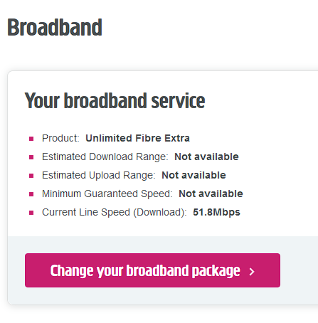

From my broadband account:

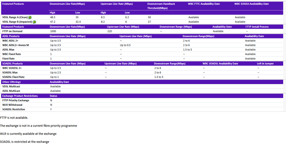

See what the following says for your line (hide personal details if screen image posted).

This is what I get by phone number:
And by address:
Thanks,
Mike

@michaelorchard If your 'current line speed' is 51.8Mb/s and your profile as reported on the BT speed test is 17.85 - 25.51, there is a good chance there is a network error.

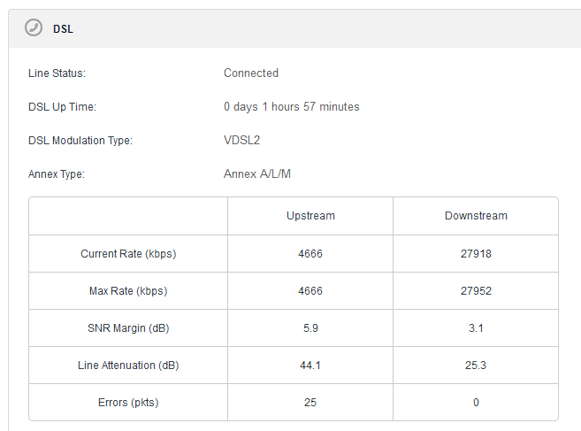

The BTW performance test was ran over wired connection to my TP Link VR400 - current connection stats are:
Up time being from the single restart I did earlier today since the drop earlier in the week to see if it would reconnect any faster.

@michaelorchard Combining those results convinces me fairly well that there is a fault in the network, although it is strange there is no network speed recorded in the BTW checker (phone number) version.
However, for your line attenuation, I suspect the D/S SNR is a little low. Did you run the phone test  as requested in my post?

Quite possibly but it’s a cheap and quick test. My reading of the fault is that the hub is in synch at 51Mbps with a SNR of 3.1dB, but only getting a download speed of half that. Amongst possible causes is the hub being in a screwed up state.

@Baldrick1 I know it is getting late, but I can't see anywhere where the hub says 51mb/s - yes it says that on the -unreliable - product page, but neither the BT speed test nor the hubs actual figures are anywhere near that - in fact the test result says IP profile is 25.51Mb/s.
