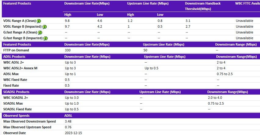

And that is one of the problems with OneDrive (pre-configured on new PCs, etc.). Assumptions are made that the connection is capable of using it. I'm of the opinion that mobile (phone) app developers also make false/incorrect assumptions.
(N.B. My experience of the same symptoms was on a ADSL connection with 0.5Mbps - 0.75Mbps upload. A number of these connections will be migrated VDSL-based solutions and only have a marginal increase in upload speeds.)
Looking back on a phone line that I know...
I'm wondering whether people is these locations will be actively encouraged to migrate to a mobile network solution for their broadband connectivity. When the mobile coverage is somewhat sub-standard (i.e. voice comms are more reliable/intelligible over a landline rather than a mobile phone at the location).
