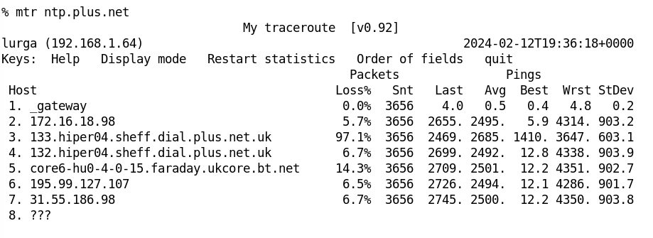

During a period of high ping time, I typically get something like the following traceroute (this one was measured over about an hour):
Note, average ping times over the hour are over 2000 ms. Needless to say, the internet connection is utterly useless. Any clues as to what's going on?

@dsberry  - just as a comparison of your mtr,  this is mine from a not Plusnet connection -
$ mtr ntp.plus.net
                                               Loss%   Snt   Last   Avg  Best  Wrst StDev
  1.|-- My-home-router                          0.0%    10    0.2   0.2   0.2   0.3   0.0
  2.|-- My-ISPs-LNS-router                      0.0%    10    6.7   6.7   6.4   7.0   0.2
  3.|-- My-ISPs-BGP-router                      0.0%    10    6.8   6.8   6.5   8.0   0.4
  4.|-- linx1.ukcore.bt.net                     0.0%    10    7.3   8.1   6.9  12.3   1.7
  5.|-- core6-hu0-0-0-19.faraday.ukcore.bt.net  0.0%    10    7.3   7.8   7.2  10.1   0.9
  6.|-- host213-121-192-65.ukcore.bt.net        0.0%    10    7.4   7.7   7.4   8.2   0.2
  7.|-- 31.55.186.102                           0.0%    10    7.1   7.6   7.1   9.5   0.7
  8.|--                                       100.0%    10    0.0   0.0   0.0   0.0   0.0

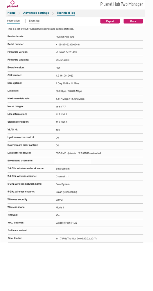

@Dan_the_Van The devices list in the advanced settings only seem to include the total data transferred since the last router reboot.  It shows that all my main devices have uploaded and downloaded significant amounts of data (but not larger than I would expect) since then.  What I'd really like to see is the current instantaneous (ish) data rates rather than the total data transfer since the last router reboot.
I've attached the technical log. Thanks in advance for any insights you can provide.

@dsberry  my first impression is that your upload "Data rate" has been "banded" but otherwise doesn't look too bad (for a long line).
Before attempting to get the "banding" removed,  I'd like to see whether your line can perform any better when just your router is plugged into your FTTC line WITHOUT the BT faceplate and without the telephone attached.
Do you have a dangly DSL filter that can be used to convert you router's RJ11 DSL cable to fit into a BT431A phone socket ?
something like this -
if so can you follow the instructions in this video -  YouTube : How to Connect into the Master Test Socket
Once you have your dangly DSL filter plugged into the hidden TEST socket, and your router plugged into the filter
can you capture a screenshot of you router's DSL "Technical log" (as done previously), so we can see if it's "Maximum Data Rate" improves, or the "Noise Margin" goes down.

The quiet line test  - both with the faceplate in place and using the internal test socket - just gives a small amount of white noise, as I'd expect from any audio device.  Below is the technical log I see with the phone disconnected.
