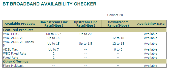

It is a chance that this is the same cause as lorisarvendu decrease in speed as discussed here.
Again your estimated speed is showing line speeds is currently similar to what you're getting.
