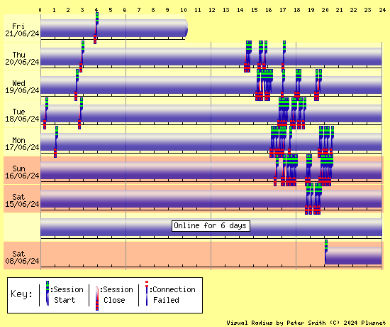

Try asking Plusnet forum staff to post in this topic a copy of your connection's "radius server graph".
If you look at a previous example here, you can see that the graph shows when disconnections/re-connections occur,
this can be useful to spot 'time of day' fault patterns, and in your case something to correlate with your weather observations.

Hi @Anunnaki  Please see my posts above, the radius server graph does show the dropouts and the I asked the plusnet adviser to send me a copy, which was agreed. However afterwards a message from the adviser said they were anable to find a way to send it.

That's why I suggested asking a forum staff member to post the image here, as they have frequently been able to do that

I see that @willcutforth has just come online, perhaps he can help by posting your radius server graph ?

Thanks again @Anunnaki  plusnet have agreed the graphs show the dropouts and that they have occured between 15.30 and 20.30 on sunny days, the problem is that nobody can understand why. Officially they are saying the fault is at the user end (me - well they would do!) so that's why I've purchased another modem to try, in order to put the ball back in their court. Strangely the faults mostly occur on Fri/Sat/Sun evenings, plus isolated times  afterwards 02:00 03:00am  when it's obviously DARK!

@Anunnaki  I now have the Radius Server Graph for this week, the problems continue unabated
