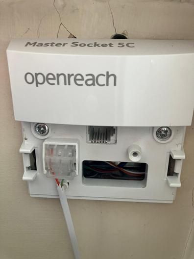

There's just one more thing you could do, which dispenses with the filter and bypasses the faceplate.
Wire the RJ11 router cable directly to the terminals on the master socket backplate as I have - see photo.
Note that for neatness I have fitted a clip-on standard phone socket faceplate over that as it's smaller, but it does nothing other than cover the hole!

If the back plate is wired correctly then you must use the unfiltered faceplate to interconnect the otherwise isolated extension output to the test socket, so you are no better off.

@Baldrick1 Sorry I'm not sure what you mean by "interconnect the otherwise isolated extension output to the test socket" as I thought it had been established that there was no extension wiring connected and none was required. 🤔
My suggestion (as I implemented) is only to simplify wiring and reduce connections/components (any of which can fail) where all you have is a broadband router connected directly to the master socket. If that's not the situation here please disregard. 😎
You are suggesting that the extension cable connectors can be used as the output to the router without fitting a faceplate. I was simply pointing out that the faceplate plug is used to connect the extension wiring, either to the filtered output of a filtered faceplate, or direct with a non filtered type. That's how extension wiring is disconnected when you remove the faceplate.
Consequently, unless you fit a faceplate the connection is not made and it will not work. So, for it to work the connection still has to be made via the faceplate connector.

I see where the misunderstanding is. You are assuming that the dedicated extension connectors that you are using are connected to the incoming cable.

@Baldrick1 I think you're mixing my posts up with someone else. 😣 My wiring is clearly (and I stated this) only for setups with no extensions, no phones, no anything JUST a router connected directly to the master socket. I have no extension wiring, no phones (SOGEA).
But YES, just to be clear, you do (I think) need a faceplate of some sort in there to make those connectors live as it bridges the upper and lower contacts on the latest type of master socket as @pvmb pointed out. As I said, I have a plain POTS-style one for neatness, not the dual outlet one.
