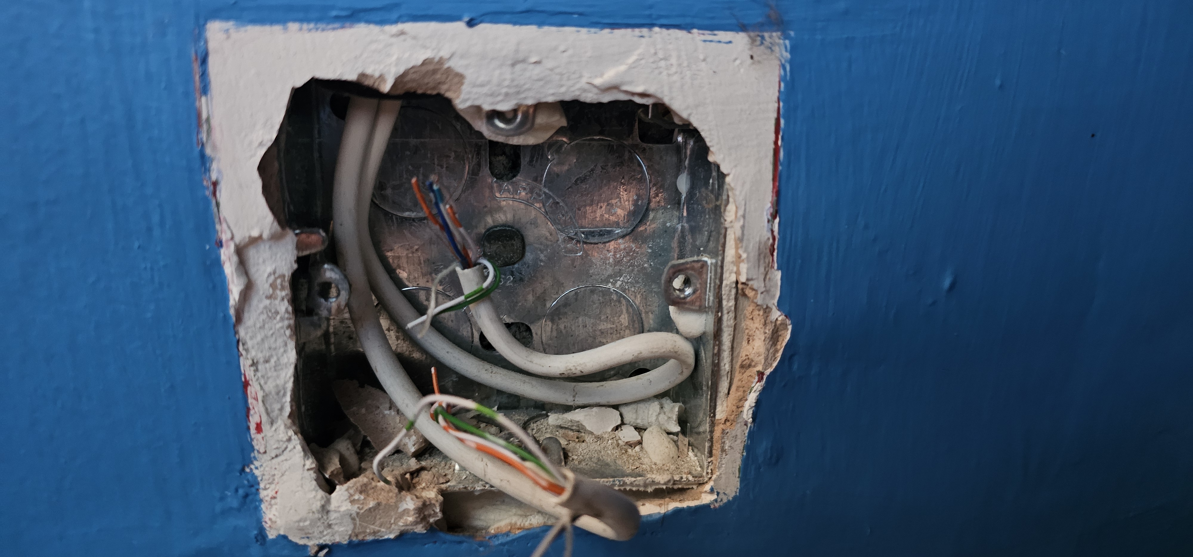

JHarland
Posts: 58
Registered: ‎20-04-2025
Re: Stuck on 40/10
Are the extension wires some of these wires....?
Posts: 28,188
Thanks: 12,603
Fixes: 237
Re: Stuck on 40/10
Where are they?  Looks like the location of a disconnected extension socket, not the master socket.
Where is the master socket with the inbound pair?
JHarland
Posts: 58
Re: Stuck on 40/10
That picture is behind the master socket. I unscrewed the screws in the attached photo
Posts: 28,188
Thanks: 12,603
Fixes: 237
Re: Stuck on 40/10
OK it was not clear free m the first picture that there is any thing connected to the cables.  Closer inspection seems to show that a pair comes out of the left cable down the bottom of the hole.
i conclude that there are no attached extensions
