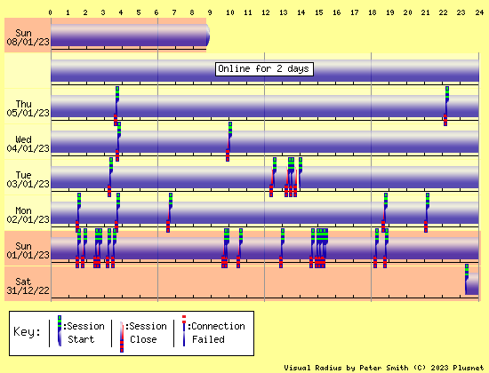

Visual Radius graphs seem to be a bit of a legacy thing nowadays, so not all agents may know how to. I've produced a graph for you from the 19th December and attached it below.

The visual radius graph does look a lot better, but not sure if the banding was holding the drops back. We’ll see. Openreach would generally deem 3 drops within 24 hours or 6 drops within 72 hours to be acceptable, providing there are no other significant issues.

Just to add a further update, the engineer visited on 3rd, and found a broken wire on the pole outside, which he showed to my mum. I'm surprised it worked at all if there was a broken wire, but he fixed it, and its now on 10 days monitoring.
Obviously i can't see what the line is doing at the moment, but hopefully it stays up now, and doesn't get banded again!

Glad to see things have been stable for the last couple of days, I'll give you a call later if that's OK to see if that matches up with your experience:
