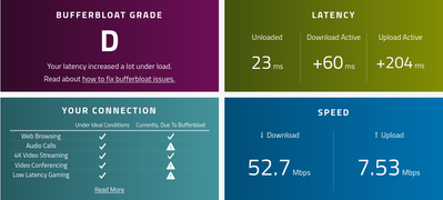

What bufferbloat grade do you get with that RAX70 setup on ADSL ?
Run this speed test - https://www.waveform.com/tools/bufferbloat
When the test completes, find the "Share Your Results:" URL (found under the test results), click on the [Copy] button.
Then paste the results URL in to your forum reply.
Re: Strange disconnects on adsl
30-03-2025 8:17 AM
https://www.waveform.com/tools/bufferbloat?test-id=beff757c-c8ce-4039-96b3-55ac807afefa
However, these disconnects don't happen under load, they appear to be more time based, more often happening in the evening between 9 and 10pm. Be interested to hear your thinking on why bufferbloat might cause disconnects.

Specifically on ADSL lines, some routers can give symptoms that have the appearance of download traffic 'hang' due to unexpected upload path bufferbloat.
HOWEVER your test result shows that you are NOT on ADSL, so the bufferbloat theory is unlikely.
You are clearly on VDSL2 (typically known as FTTC or SOGEA)
I'm baffled that you have such an amazing router, and allow your connection to run with such high latency !
If you look at the User Manual for the RAX70
Go to page #96 and follow the instructions for "Enable Dynamic QoS"
then on page #97 ensure to "Enable the automatic QoS database update"
Now run the bufferbloat test again, your router you should be able to achieve an 'A' grade.

I can get a B rating, which is better, so will leave QoS on.
https://www.waveform.com/tools/bufferbloat?test-id=a7b1d125-8fe7-4e78-8a45-33f23028786e

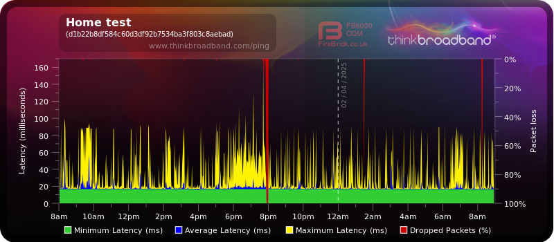

02-04-2025 8:59 AM - edited 02-04-2025 9:00 AM
Even with the changes in place, i still had the same issue last night at about 8pm. (the 8am one was a forced disconnect as i was moving my modem)
