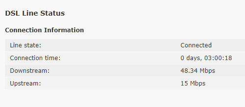

Line dropped this morning, sync speed even worse now.

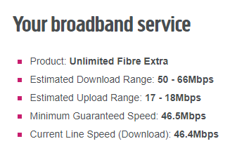

As a result my speed is well below the downstream handback threshold.
