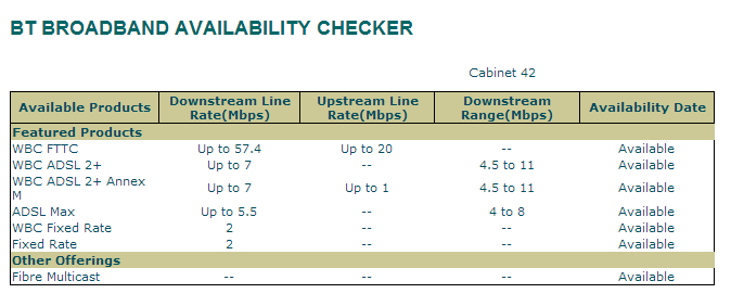

Hi there,
I've checked over your connection and can see the decrease, I've also checked you estimated speed and can see that it's at 57.4Mb/s
It's more than likely down to more uptake at fibre at your cabinet, this can reduce your speeds due to crosstalk.
