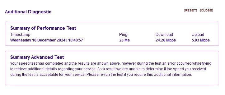

Since then, my speeds have been much lower, around the 30 Mbit/s d/l mark and I’ve had a couple of disconnections lasting at least 12 hours.
This week my speed’s been down as low as 24 Mbit/s d/l and is currently sitting at 27.4 Mbit/s, both of which are below my guaranteed minimum speed.

Thanks John.
All info posted below, as advised. 👍

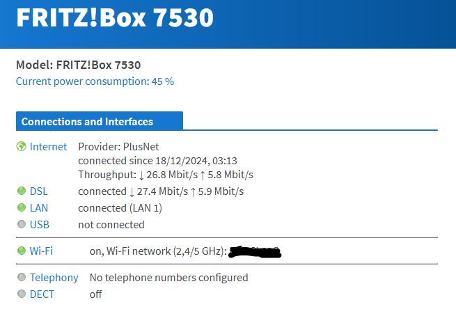

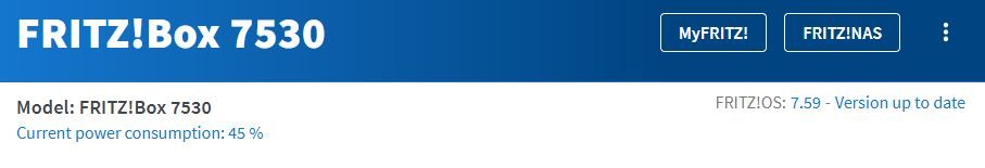

"Router is a Fritzbox 7530 (no change in firmware either)."
Are you absolutely certain that your router has not had a firmware upgrade in the past few months? What version firmware do you currently have?
That router is the one that used to be supplied by Zen Internet to their customers, (they now supply the 7530AX that I have).

Hi Mr_Paul,
I am absolutely sure (see pic below). I have disabled auto updates for firmware and always check various forums before considering any update and noted the same comments that you refer to. As far as firmware goes, I'm in the "if it ain't broke, don't fix it" camp.

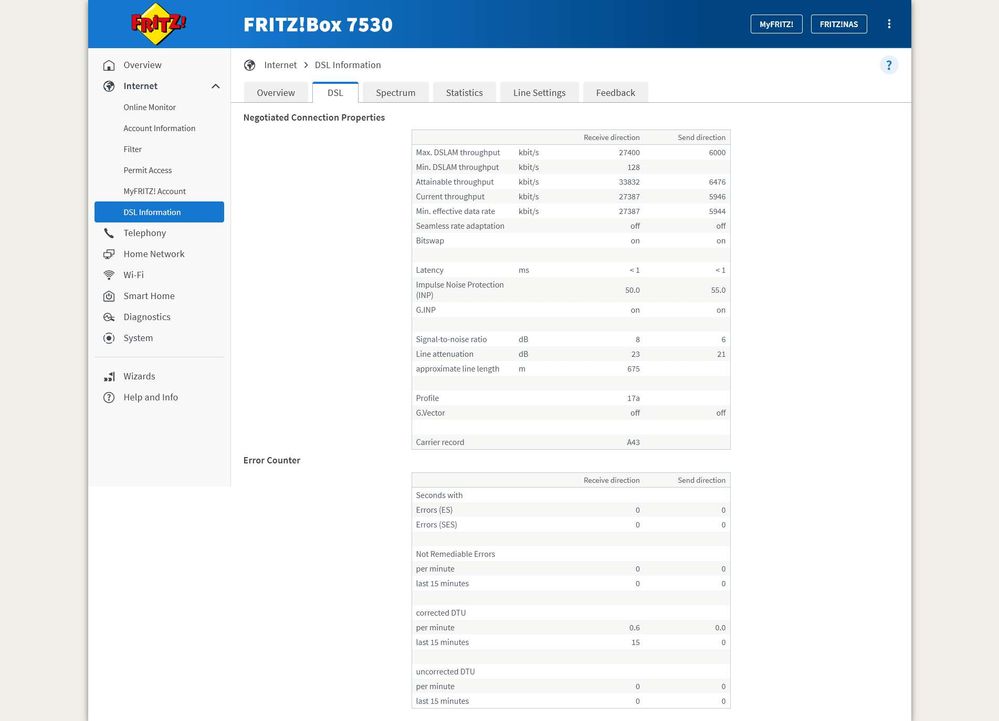

@Norbert Thanks for your posted info. Your phone test is good news - at least that side of your line is OK.
However, your DSL uptime is a little disconcerting at only 7 hours - I am assuming you don't intentionally turn it off?

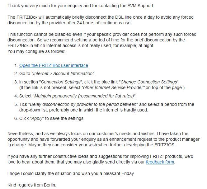

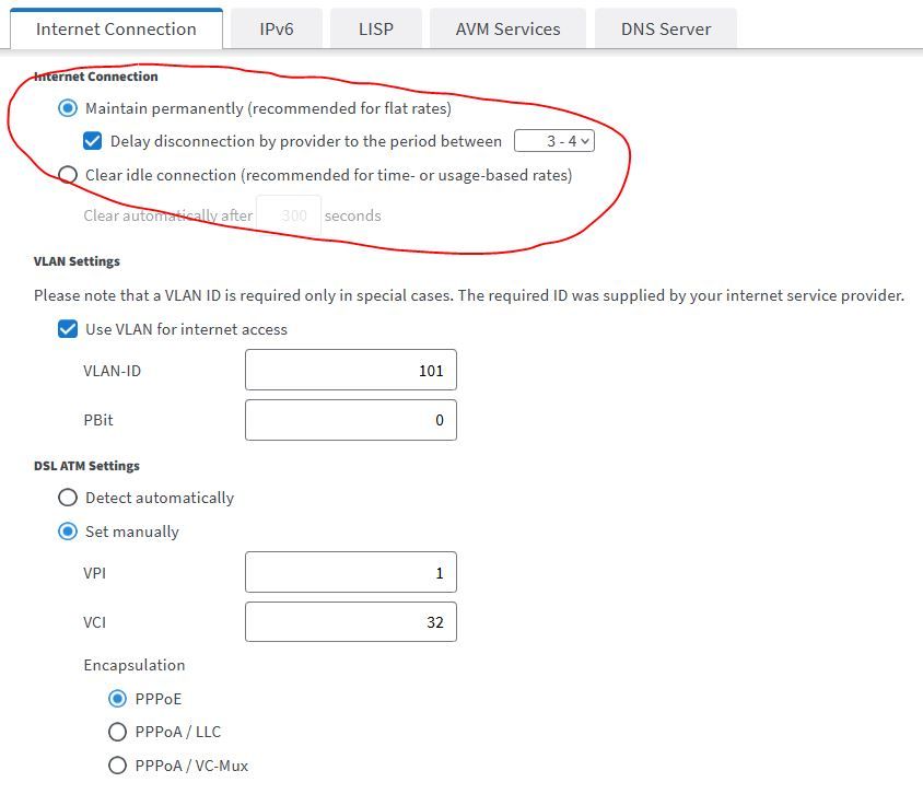

@jab1
No, there is a daily auto disconnect 'feature' built into the FRITZ!Box (see pic) that means it disconnects once a day briefly "to prevent the internet service provider from disconnecting you in the immediate future." and although the "Delay disconnection..." check box suggests that this can be turned off, I have confirmed with FRITZ!Box tech support that it actually can not.
It's always been like this though so, in that respect, it's not changed since I was actually having decent speeds.

OK - my Fritz!box - on a Zen connection - doesn't have that feature, but to be honest, i don't see why that 'delay disconnection' box cannot be unticked, just leaving you with 'Maintain permanently' filled in. AFAIK, Plusnet don't intentionally disconnect you, and I can only assume that is something possibly unique to their primary market - Germany and possibly other EU members.
In any case, that does not explain why you have only been up for such a short time - your connection should hold for very much longer, unless there is an underlying issue.

You'd think so, wouldn't you, but here's the reply I got from AVM tech support.

I can't argue with that, although I don't see the logic.
However, I was on FTTC with Zen for 30 months, and my connection stayed up for weeks/months, only losing DSL when they pushed through Fritz!box updates, or there were issues on the BT/OR network.
