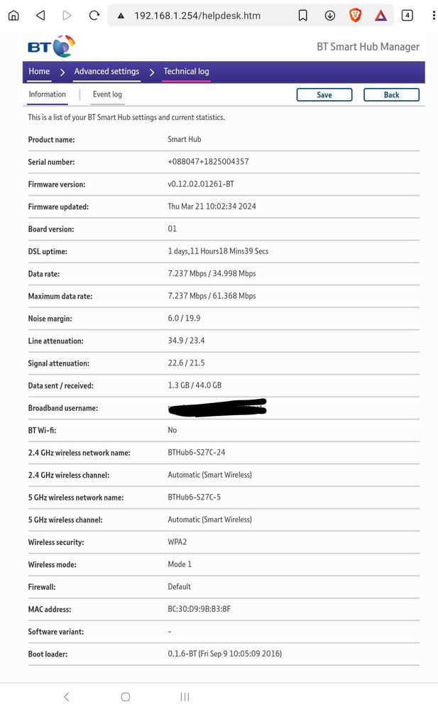

Hi, my max connection rate has been set at 34998kbps for the last three months. As recently as June it was 54998 or 49998. My minimum speed used to be 36mb, but now I only get 31 or 32mb downloads.
Is a line reset possible?

@MartinConnolly Looking at that data, you have an extremely high SNR, which could indicate a problem.  If you still have a phone-line, I suggest you check there isn't a problem on the voice circuit - dial 17070, select option 2. The line should be totally silent after the confirmation of your number except for the regular 'Quiet Line Test' message - any other noise, report a PHONE problem.
If the line is silent, a reset may resolve your problem, so long as there isn't still a problem on the VDSL side, although looking at your uptime, I suspect you may need an OpenReach investigation.

@jab1 l'll do the quiet line test this evening and let you know. The uptime is a bit of a red herring as I rebooted the router (in case it cleared the wrong location error I also posted about). I can post the full event log back to 1st Feb this year if that helps?

Thanks, @MartinConnolly - at a quick glance, your DSL link seems to maintain for a long time, so, although I would not be too happy about losing it quite as often, I doubt a complaint would get much attention these days.

@MartinConnolly  - just looking at the last entry after a drop on there, it is reporting an 'up' connection speed of 7237kbps - but no down speed.
Any chance of posting the result of a test from https://www.speedtest.net/ , please?

That speed test is informative - thanks. The ping and jitter times are a little high, but not super-excessive, but noise on the line should not be there - at all, on a QLT.
I suggest you report a phone issue via https://www.plus.net/help/report-a-problem/ , and  keep us informed of responses.
