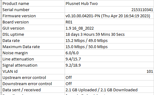

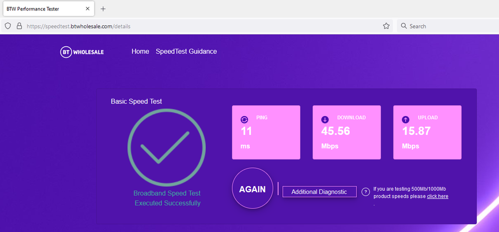

Here are my hub stats and speed test taken on 9-Oct prior to the switch:

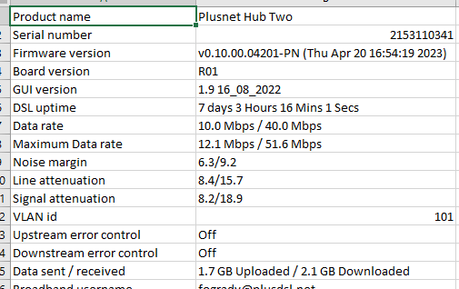

And here is the same info after the switch:

@TheFog Looks like you may have a fault - your D/S SNR looks a little high.
Re: Speed drop following switch to SOGEA
31-10-2023 9:43 AM
Since your product change your data rate appears to be exactly 10Mbps up and 40Mbps down - that suggests you are now on a 40/10 profile.
The maximum downstream data rate is similar to before (although upstream looks a bit lower)
31-10-2023 9:44 AM
That would be because judging by the sync speeds, it looks like its been provisioned on a 40/10 profile!!
Very strange. I thought SOGEA was 80/20...

OK I just reset the router and it has reconnected, here are the stats again:
It does appear to be "stuck" on 40/10.
31-10-2023 10:01 AM
Plusnet need to (get OR) to get you onto the correct profile.
Another concern is that the maximum upstream rate has dropped again - was 15Mbps before the product change, 12Mbps after the product change, and 11Mbps after the reboot.

@TheFog Your max data rate seems to contradict that - or is it a 'fault' of SoGEA, @MisterW / @Dan_the_Van ?
31-10-2023 10:04 AM
@jab1, the purpose of a profile is to limit the rate - which is exactly what's happening. The maximum is the limit of what the characteristics of the particular line will support - that isn't affected by the profile..
