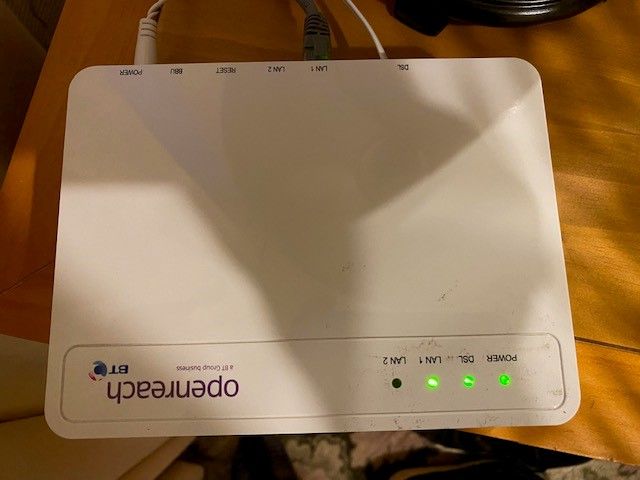

Hi, I have the below supplied Openreach modem, connected to my own TP Link Deco M5.

Is your TP Link compatible with Fibre without the modem?

No Sorry, it does not have a built in modem.

Hi @richardjh, I've just performed a line test and it's showing signs of a "high resistance cable fault" so it would be best to book an Openreach engineer visit.
Can you let me know your availability for these slot times please?
