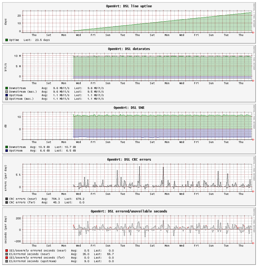

Just an FYI (while I'm here crying about my emails elsewhere!)... this is why I intervene and why I do not want DLM to protect me!!
This was taken just before a power cycle on 24 Jan 2025 at 22:16 (all telephones and the new phone extension firmly in place throughout, xmas lights etc) showing a few weeks of the stable connection I can usually enjoy when DLM doesn't interfere! Syncing faster than DLM allowed (albeit somewhat nobbled by SQM limits of around 7.6 Mbs - but no extra lag/bufferbloat) with higher SNR margins.
I'm adding +4.5 dB (ish) to SNR margin and I have had no unexpected disconnects. I've had power cuts and a noisy gateway, but the line holds on for the next timed/controlled reset.
I still get nice bursty spells of errors of 20k+ in a 5 minute interval... but no obvious pattern and it doesn't last long as the errored seconds don't seem to peak in line with the errors (so I guess they all happen in the same second?). And I get the odd spell where the entire period seems to be full of Errored Seconds (even some consecutive/severely errored seconds)... but the connection persists!
I hope this helps demonstrate why solutions that work well generally (ie DLM) will rarely provide the best solution for anyone... and that is why I interfere.
I'll see you next time I get too cocky/complacent with my line or DLM has a brain f@rt and nobbles me prematurely!!

You clearly have a source of REIN. Finding and if possible eliminating it might give you a better experience.
