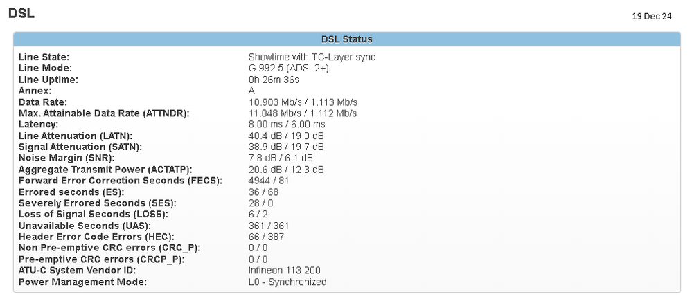

Thanks @Gandalf - I was trying to game the DLM into thinking I had rock solid stability (to get Auto-unBanded!) so I tried to apply a +1.5 SNR tweak on my modem... hence the unusual synch SNR.
I'm gonna need to up my SNRM... am I currently on a training period?
I wanna repeat my apologies for this little event... I brought it on myself by running my line at its limits and not watching the errors ramp up into the millions. Just timing/life! I will try to do better.
No, but I'd still try and avoid making any changes for around 3 days though.

I'll try and help it out by keeping my SQM values low - but I think the lack of available bitswaps will still get me when I get a noisy burst!!
Still, my guess is if it fails it will come back up with a DLM adjusted target of 9dB... with my current +1.5 adjustment it should be perfect!
