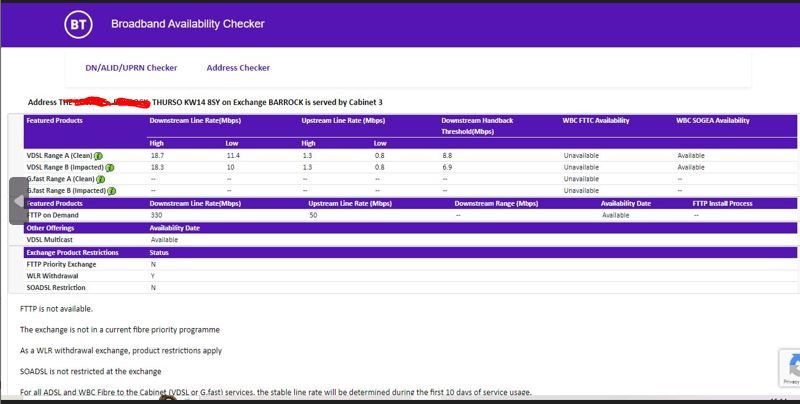

My broadband speed has never been perfect because of where I live but it has managed to keep up with everything such as PV, laptop, Ring cam, TV. However these last few days everything has gone really slow yet my speeds are the same at around 15 download and .65 upload, done using an app on iphone. Netflix and Prime are the worst hit, sometimes not able to watch at all. I have rebooted the modem and done all the other stuff suggested but to no avail. Nothing has changed to cause this that I know of. Can anyone help? ps The BTwholesale speed test wouldn`t work, maybe it`s a clue this is their message...
Summary Advanced Test
The Performance Tester is currently unable to run a speed test for your broadband connection. Please try again shortly, however if this problem persists, raise the issue with your service provider.
The ping test it did is 1325ms

@destiny234 Looking at those speed results, I am assuming you are on an ADSL, rather than FTTC? The ping figure you report certainly wo't help either - it is unacceptably high.

John yes I am at the very end of the line. there are often problems when it rains heavily but it`s been dry for several days now
Linda

John, Sorry I could only attach the photos, couldn`t see how to put them directly into to chat box.
Linda

Can't see them, Linda. If you are using a desktop/laptop, use the 'mountain' icon above the reply window.

broadband availability checker 2.JPGspeedtest bt wholesale dignostics.JPGbtwholesale.JPG
