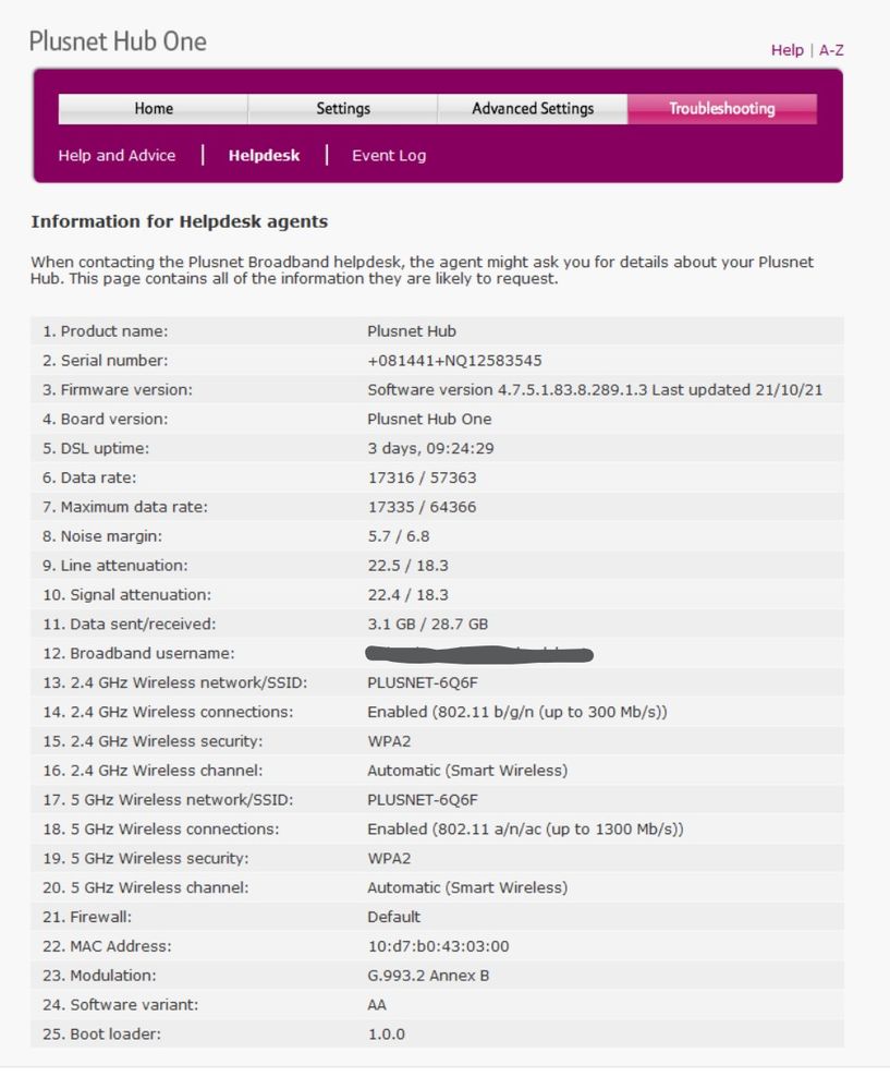

@NicDB Sight of your current 'Help Desk' would be interesting.

Sure, now attached.
Re: Speed Keeps Dropping - Massively
10-06-2023 4:34 PM - edited 10-06-2023 4:40 PM
Very strange - that is showing a data rate not too far short of your maximum. What speed tester are you using?
Going back to an earlier question, your phone line test should be totally silent apart from the 'Quiet Line Test' announcement.
Another point from that screenshot - something is hammering your connection, looking at the data sent/received figures.

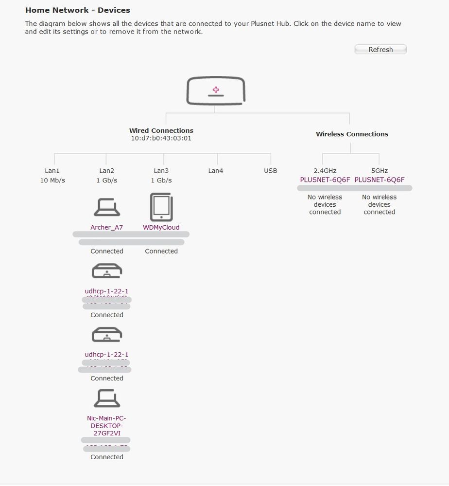

Yeah, no idea what is hammering the bandwidth. I've disconnected the upstairs Firestick and the Amazon Echo Dot and the RaspPi camera. The two LG smart TV's apparently shut down the app when you close it. No idea if this is the case as hard to test for. I deleted the devices not currently connected and refreshed the home network page and this is what is typically connected.
Wife watches a lot of streaming TV shows and we do as a family in the evenings 2-2.5 hours. Don't know how much traffic this generates?

"The two LG smart TV's apparently shut down the app when you close it. No idea if this is the case as hard to test for."
Is it not possible to try switching these two TV's off at the mains socket over-night, and monitoring the data consumption?

You have the 'MyCloud' connected, and what is the Archer_A7?
Just as a suggestion, can you reset the Hub, which should clear the data, and see how much is shown after, say, 24 hours?

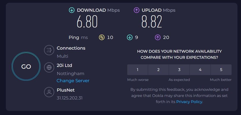

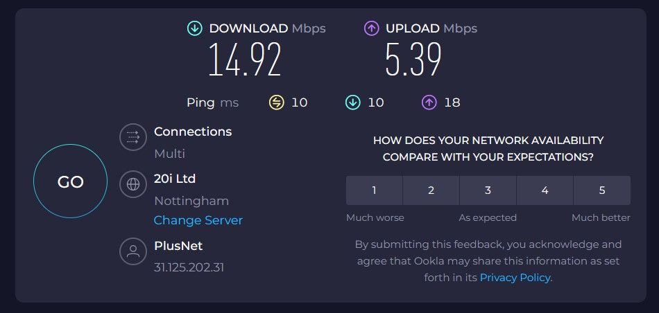

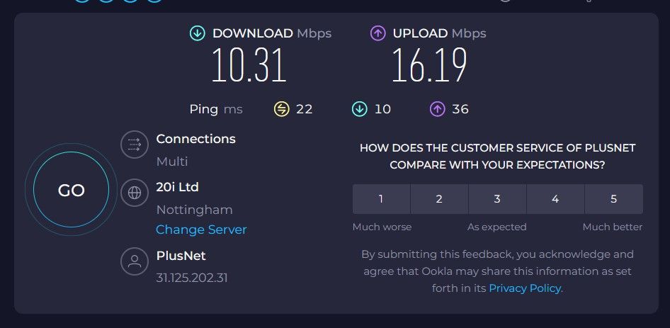

Also, can you run the Ookla speed test and post a screenshot of the result ( https://www.speedtest.net/ )

Yes, i have a NAS drive connected to the Router. I could disconnect for a couple of days. The Archer_A7 is an Access Point router downstairs.
Ookla speed tests attached. Three runs. All very disappointingly slow!
