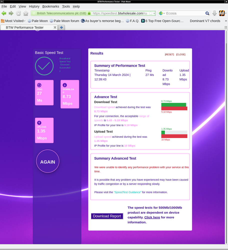

I have a fibre package and I live in a rural area so I am a long way (about a mile) from the cabinet. Originally I was getting a connection speed of about 12.5Mbit/s as reported by the router's and various online speed tests.
This winter there have been a number of intermittent disconnections during bad weather and power cuts. When the modem has reconnected, it has been reporting ever decreasing speeds. It is currently down to:
Downstream:9.489 Mbps
Upstream:1.149 Mbps
The upstream rate has also decreased from about 1.5Mbit/s originally. I have confirmed the reduction in performance with various online speed testers. This equates to a performance drop of over 30%.
My physical set-up has not changed. I have the original Plusnet router and the configuration has not changed.
I rely on this connection for work, and I am starting to struggle. If it gets any slower, I will need to choose an alternative.
Could this be a physical problem with the connection to the cabinet?

BTW Performance Tester - Over a wired (Ethernet) connection if at all possible, please report the 'ADDITIONAL DIAGNOSTICS'. This test is recommended to be performed with only one device connected.

Looking at that, you have a couple of problems. I'm out for a couple of hours, but if no-one else responds, I'll comment when I return.

@ijn667 your downstream noise margin is slightly elevated ( 8.7db ) which would indicate that the DSLAM has raised the target SNR from 6db to 9db to attempt to reduce errors. This will be the cause of the reduction in downstream speed. However your speed is above the handback threshold (showing as 6.3Mb) , so getting Openreach to investigate a possible line issue will be tricky.

@ijn667 - Hi, I have tested your phone line which tests fine and I've tested your broadband also tests fine. The sync rate is 9.5/1.1.
Looking at this solely as a broadband issue, it's performing above the sync rate we'd expected and likely causing the higher error rates causing the speed test loss of 30%. Eventually, the sync rate will reduce the sync rate still in line with your estimate of 8.4 and you will likely see a lesser % between the sync and the speed observed on the speed tester. I don't really have the justification to report this fault to Openreach at this stage.

Your line attenuation implies a line length (by whatever route it takes) of about 2.6Km, over 1.5 miles. Nonetheless it "should" have a download speed of around 11mbps (you noted 10.5mbps which is consistent).
As noted above, your noise margin has been elevated from the normal 6db to around 9db which would explain the speed reduction. The question then is why and can anything be done about it?
