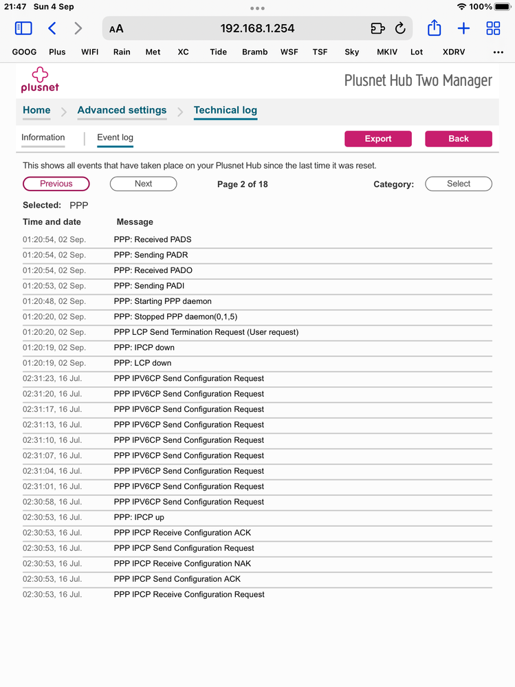

04-09-2022 10:01 PM
It held for 48 days at 70mbps, reset on Friday and dropped slightly to 65mbps, hopefully not on a slow down again.
