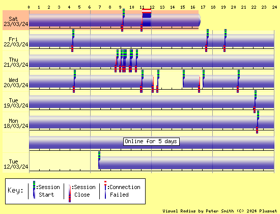

@alfie00 It would be best to go back to basics rather than trying to get into line attenuation and SNR margins. FYI, you're banded at 1Mbps(WBC 576K - 1M Medium delay (INP 4) 6dB Downstream\, UC Low delay (INP 0) 6dB Upstream (ADSL2+)).
Here you can see the drops @ http://visualradius.plus.net/visualradius/generated/image17112118748117.png providing you're not rebooting the router which will show on that graph, we need to eliminate what we can in your property and get an engineer out.

Re: Slow Broadband speeds
23-03-2024 5:02 PM
@James30 Thank you for that VR plot - interesting. I am aware that all ISPs seem to have been advised (by OpenReach?) to blame a customers environment before they will look at a job, but this customer had been perfectly happy with a stable connection for years (apparently) until the time when he started this topic. As you have kindly provided his profile - which is horrible - it should be obvious that he has got his internal setup correct, and, with due respect, it should also be obvious that the issue is somewhere external to him. He may have caused some of those drops if he has followed suggestions earlier on in the topic, but certainly not all of them.

James30, when you report to me "FYI, you're banded at 1Mbps(WBC 576K - 1M Medium delay (INP 4) 6dB Downstream\, UC Low delay (INP 0) 6dB Upstream (ADSL2+))", I presume this is controlled by the kit in the exchange.
Within regards to drops, I have restarted the router using the GUi, a few times over the last week. This would account for some of the drops.
