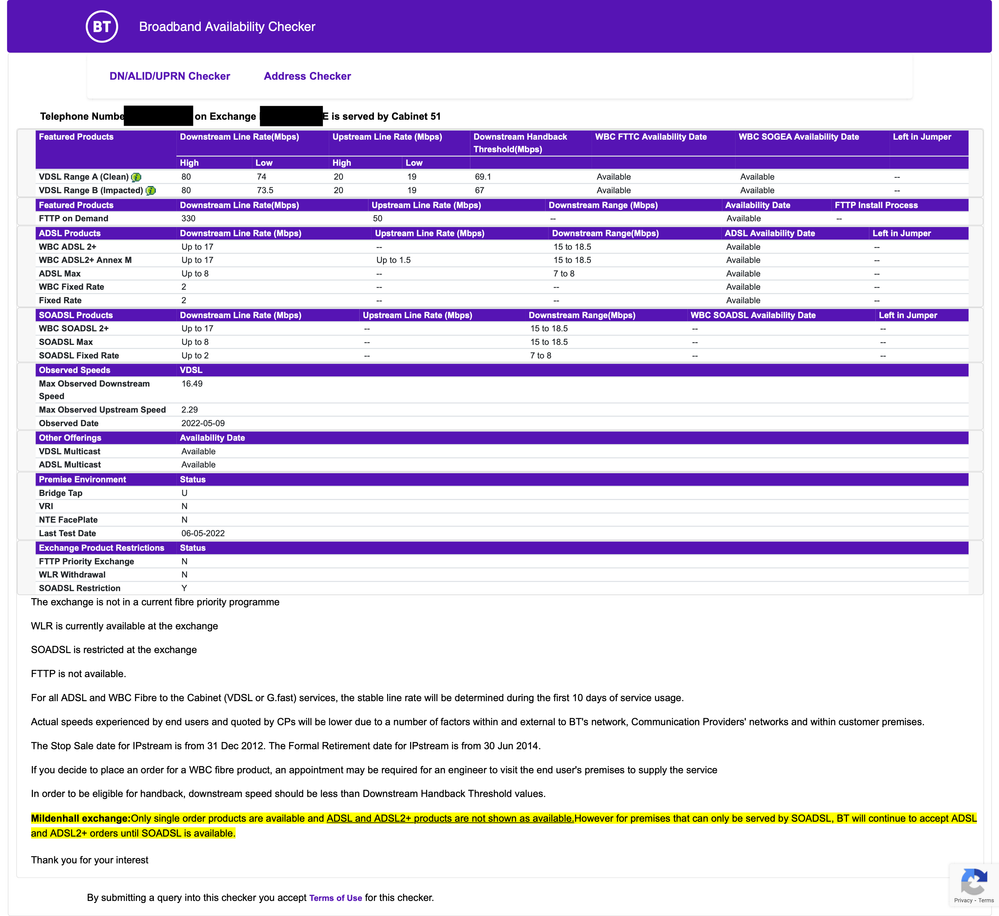

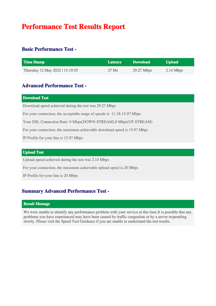

I am subscribed to the fastest internet speed up to 72MBPS.
I have had previous issues with slow broadband speeds - more recently in Oct 2021, engineer came and said they needed to move the master socket. The speed did improve but now I am experiencing slow speeds for the past 6 weeks ie only 16-17 MBPS. Uploads speeds are worse.
I would appreciate if someone can look into this to be fixed again.
Stats of line check as attached which is self-explanatory. Tests were done with a wired connection using the Plusnet hub and with the master socket. No issue with phone line test ie no crackling.

@voctave You have some very strange results from the BT speed test with a download speed almost double the IP profile which should not be possible. You have had stupidly low sync speeds on the 9th of May of 16.49Mbps and 2.29Mbps upload. You should be getting 80/20 speeds. Are you able to test if your phone works? I suspect you have a break in one line of your incoming pair of wires so the phone will not function. You need to raise a speed fault with Plusnet as suggested by @jab1

Looking at your Help Desk page, your SNR figures are horrible - this certainly won't be helping, but we need to know why they are so bad - an investigation by BT/OR is required.

As mentioned earlier by @RealAleMadrid your BTw test report says you are getting around twice your profile speed, which again - to me - points to a BT network issue.
