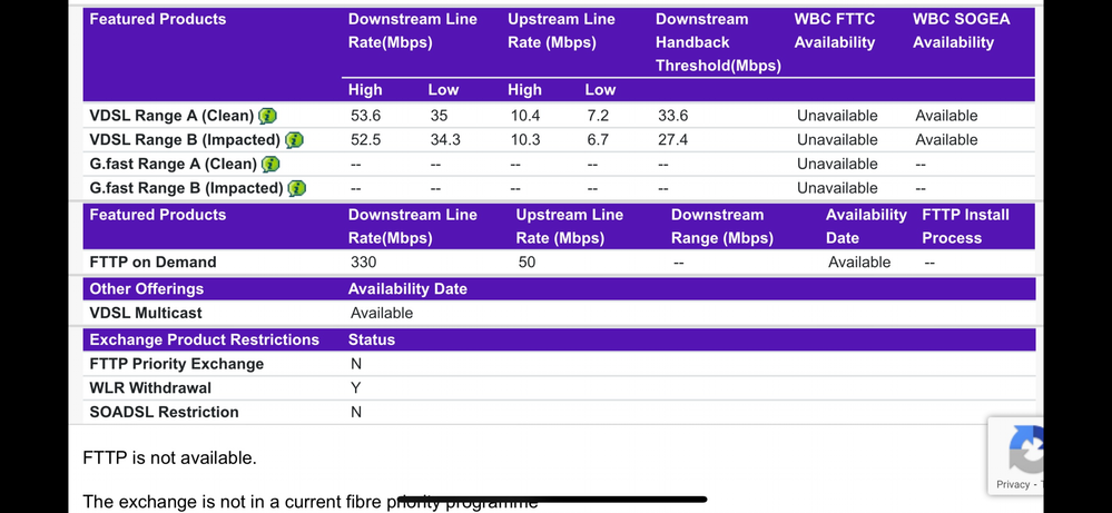

Please see the following link for results from the BT Wholesale Checker. There is no FTTP in the area, we are not in an FTTP priority area, and restrictions on wholesale line rental products (non SOGEA FTTC, etc) do obviously apply as they do now nationally.
So the only product available is SOGEA. The estimated line speeds, even impacted, are not being achieved now but were prior to my line switching to SOGEA.

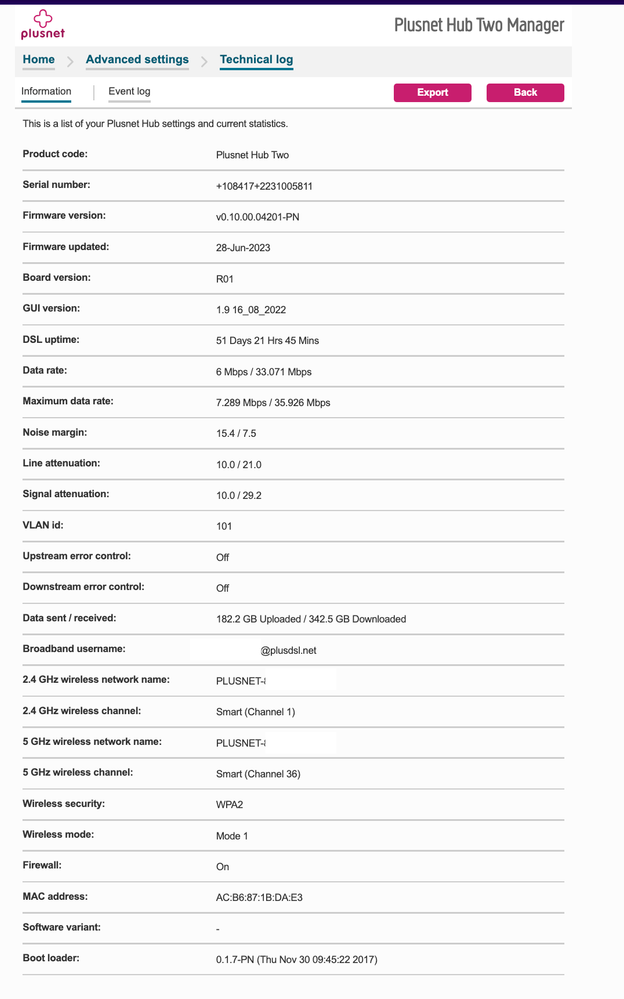

Re: SOGEA line issues and ORDI required?
Thanks jab1 - I must be on the right track if I have done most of that already! Quite amusing!
Here is the log page from my Hub. As you can see, it's not that I have poor line uptime, as my connection has stayed consistent, but the sync speed is much lower than expected (and lower than previously).

Thanks for that, @lesleys . The only thing that makes me 'raise an eyebrow' is your downstream SNR at 7.5dB - it does suggest there is an underlying noise issue on your line which may be difficult to trace, but will be affecting your achievable speeds. From memory, at a 10/21 attenuation, I would expect an achievable somewhere in the high 60's Mb/s.

Interesting, I don't have a saved copy of the Hub Technical Information page from "before", but I seem to recall a sync speed that was around 60Mbs (63Mbps, I think it was) and regularly achievable speeds of high fifties (more like a speed that hovered between 55-60Mbs than what I get now, which tends to however 20-25Mbs).
I'm technical enough to do the basic troubleshooting and check my hub easily, but not interpret the noise ratio as you have done so thank you very much for that!
