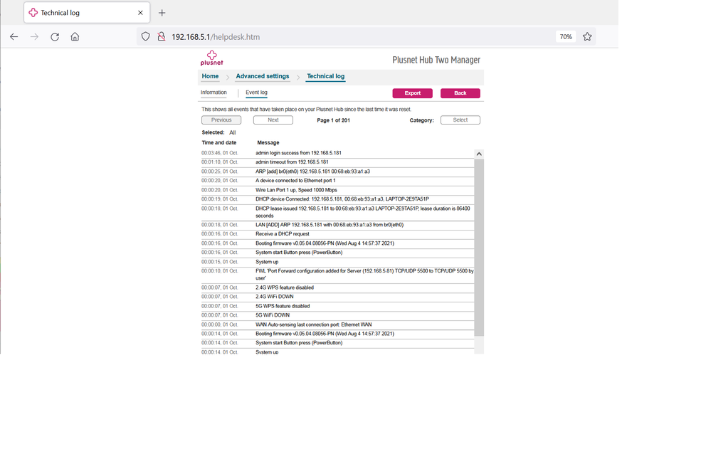

A picture paints a thousand words. Log into the Hub, and then negotiate to this page. Once you are there, hit the 'export' button and attach the resulting file to a reply - we can then examine that.

That is not the error log - you have posted the Technical Information page, which kind of helps, as it shows you are disconnecting from the internet.

Quiet line test - no noise. Attached the event log.

@Dan_the_Van Looking at that Error log, I'm suspecting a duff Hub, but maybe I'm wrong?

This is the last DSL link message
03:41:42, 10 Apr. DSL Link Down: duration was 75464 seconds
There are many "PPP: Sending PADI" messages that the WAN log is full.
There are PPPoE disconnects   PPP: LCP down which the Hub is not recovering from.
Could be the Hub or the port/card it is connected to

I'll look out for your questions, be interested if the light goes solid orange during the outage, not expecting flashing as the DSL connection has not dropped
06:40:24, 21 Apr. WAN Sensing Auto sensing Complete, interface selected
06:40:24, 21 Apr. SIP WAN DOWN
06:40:24, 21 Apr. PPP: Starting PPP daemon
06:40:23, 21 Apr. WAN Sensing Auto sensing Running
06:40:23, 21 Apr. WAN connection WAN2_INTERNET_PTM disconnected.[ERROR_NO_CARRIER]
06:40:22, 21 Apr. PPP: Stopped PPP daemon(0,1,5)
06:40:19, 21 Apr. PPP LCP Send Termination Request (User request)
06:40:16, 21 Apr. PPP LCP Send Termination Request (Peer not responding)
06:40:16, 21 Apr. PPP: IPCP down
06:40:16, 21 Apr. PPP: LCP down
20:55:14, 20 Apr. WAN Sensing Auto sensing Complete, interface selected
20:55:14, 20 Apr. SIP WAN DOWN
20:55:14, 20 Apr. PPP: Starting PPP daemon
20:55:14, 20 Apr. WAN Sensing Auto sensing Running
20:55:14, 20 Apr. WAN connection WAN2_INTERNET_PTM disconnected.[ERROR_NO_CARRIER]
20:55:13, 20 Apr. PPP: Stopped PPP daemon(0,1,5)
20:55:10, 20 Apr. PPP LCP Send Termination Request (User request)
20:55:06, 20 Apr. PPP LCP Send Termination Request (Peer not responding)
20:55:06, 20 Apr. PPP: IPCP down
20:55:06, 20 Apr. PPP: LCP down
The two surviving PPP: LCP down message look the same
