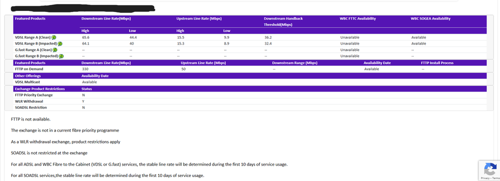

@nick44 It may be tomorrow now when  I can respond further, but can you post (1) the results from https://www.broadbandchecker.btwholesale.com/#/ADSL/AddressHome obscuring your address, (2) the results of a speed test from: https://www.speedtest.net/ (3)your Hubs Technical Log - Information page - assuming you have a Hub2.
That will give us a chance to determine where things have gone pear-shaped.

Screenshot - 30_08_2025 , 22_53_26.pngScreenshot - 30_08_2025 , 22_55_16.png

These are my results, but I'm struggling to access my router. Its not the Plusnet hub, its a TP Link router. We only had an engineer out maybe 6 months a go to fix an issue and they found no issues with the router at that time. Plus, as I commented previously, my line was running at around the 40mbps mark the day before the change of contract and it then switched to the much lower speed upon the new contract starting so it would be freakishly unlikely for a problem to develop at exactly the same moment as the contract changing.

@nick44 Looking at those two screenshots - (1) your achieved speed is below the hand-back threshold, so you are within your rights to insist Plusnet investigate the issue and get it resolved. (2) your upload ping is possibly not  helping, but the cause of that needs a separate investigation potentially, and is outside my scope of experience.
