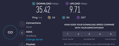

The master socket and faceplate have not been replaced but when they changed the pair to clear the fault they tested the line and verified that the whole chain was good. I assume when they changed the pair they had to re-connected on the DSLAM end but whether they used the same card or a different one I don't know.

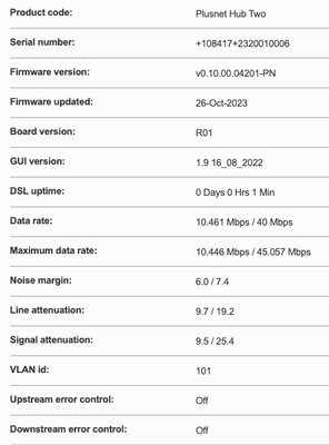

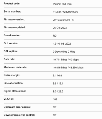

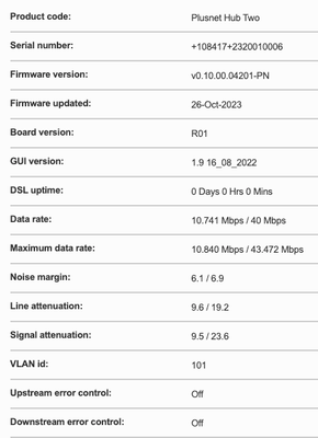

I've also just completed a bunch more testing with 4 different filters and cables using hub 2 and they all produce the same results: Data rate bang on 40Mbps every time, Maximum data rate varied between 43.3Mbps and 45.0Mbps (which is curious because why would the Data rate stay fixed at 40Mbps when the Maximum data rate is faster, I probably just don't understand what the Maximum data rate is I guess).
@Anonymous suggested a test using a RJ11 to BT431A cable which I don't have but will do as soon as the RJ45's arrive.
Here's the screenshots, the filenames should provide context:

@chevybeef wrote:
I've also just completed a bunch more testing with 4 different filters and cables ...
As you appear to have at least four working filters, did you do any of those tests plugged in to the "TEST SOCKET" ?
as you could use a dangly inline filter to convert your existing RJ11/RJ11 DSL cable to phone plug - instead of an RJ11/BT431A cable.
When connected in the "TEST SOCKET", if your download "Maximum data rate" doesn't jump much above 45Mbps, then you are probably wasting your time unless you can prove that there is a line fault.

05-04-2024 2:33 PM - edited 05-04-2024 2:44 PM
All done using the TEST_SOCKET:
Re: Reduced speeds over the years
05-04-2024 2:36 PM
Perfect !
What is the length of the DSL cable between your router and those filters ?

Ok, 2m shouldn't be enough to cause the speed loss you've described.
Have you run the Plusnet "Troubleshoot by text" to see if there are any problems detected by the automated line checks ?
If you run it again and it finds nothing wrong, I seem to remember that you can respond if you think that there is still a problem, and that subsequent step will often reset your connection and try again. If that fails, it eventually asks whether you want to receive a call from a human, reply and take that call, and explain to support that your line is banded at 40Mbps, and hopefully they can initiate a DLM reset.
For what it's worth, your modem stats look like the fastest you are going to achieve is 42Mb if you are able to get a DLM reset.
