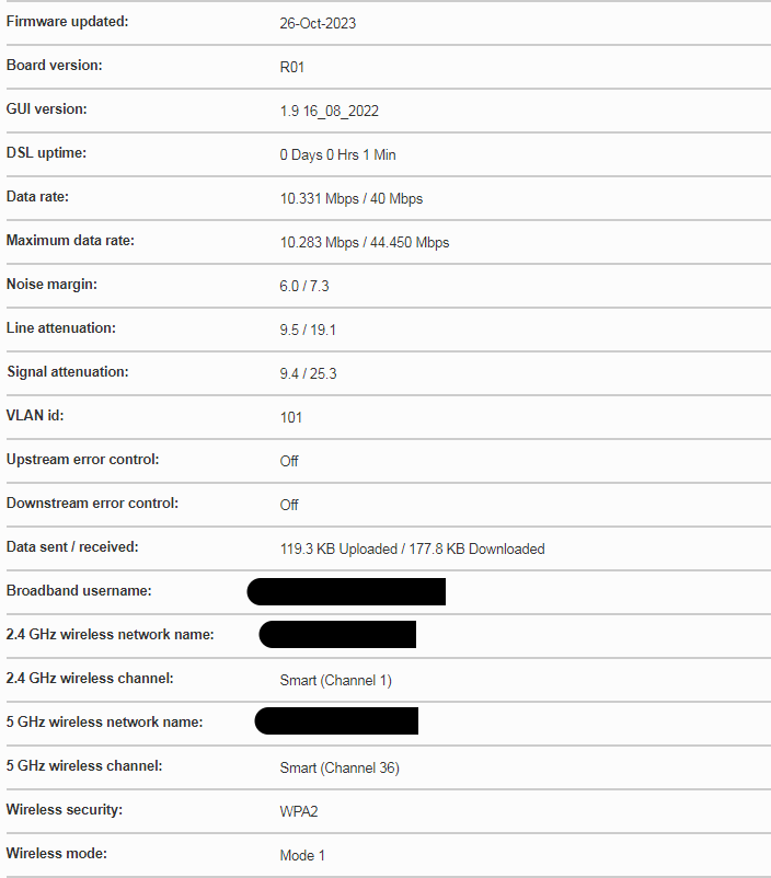

Thanks John, images below:
Re: Reduced speeds over the years
30-03-2024 2:42 PM
Unless you've been turning your Hub on and off - you are suffering xDSL drops. Is it a Hub1 or Hub2?

OK. I don't know what logging the pfsense has, but it would be interesting to see the connection details - the other option is to leave the Hub2connected for a few days to obtain logs from that. Note you will be unlikely to get a staff response on here until Tuesday at the earliest.

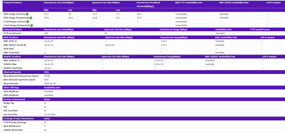

@chevybeef The speed is below the Minimum speed. What checks have been done? 38 is what I am seeing. Hardly any drops from our side as well.
30-03-2024 3:06 PM - edited 30-03-2024 3:07 PM
Thanks for proving me wrong @willcutforth 😉 - but unfortunately that 38Mb/s is above the hand back, so I doubt PR will want to investigate?

@willcutforth I've done speed tests using my normal router, pfsense, and hub 2 using various sources, see from post 29.
BT Broadband Availability Checker and broadband connection status from my Hub can be seen in post 31.

are you using the hub two in bridge mode for you router?
It is possible to check the DSL line stats on the Hub without the need to switch it out of bridge mode.
To achieve this you can connect a pc of some sort to a spare Lan port with a static IP Address in the range the hub was before in bridge mode, a suggestion would be 192.168.1.10 mask 255.255.255.0
You will have access to the Technical log
HTH

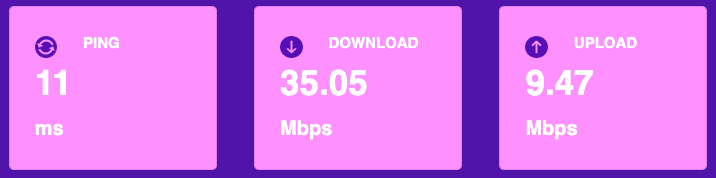

04-04-2024 12:33 PM
From my perspective as the end user I'm consistently seeing less than the 38Mbps "hand back" speed that's been mentioned above.
Today's speed test results are:
Downstream Handback Threshold (Clean) is given as 32.4 Mbps in your screenshot. That applies to the line rate, not to speed test results. You appear to have a line rate just short of 40 meg.
In actual fact although it's of interest, the literal meaning of the Handback Threshold is that it gives a qualified right to cancel without penalty. That's probably not what you want. See some notes here ..

Thanks for the explanation.
You're right, that's not what I want.
The 40Mbps line rate and 39.99Mbps in the screenshot, seems "artificial" or capped?
