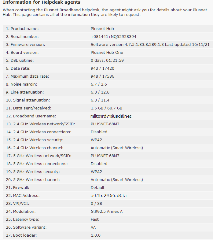

Since then the connection has been pretty good until the last couple of days. Last night the connection was dropping almost continuously over about half an hour, and the downstream noise margin is much worse than it was last month. See attached screenshots, one from RouterStatsHub and the other from the Hub One diagnostics screen:
I have changed absolutely nothing in my setup at home, so I feel sure the problem is not mine. Is this enough to raise a ticket with plusnet?

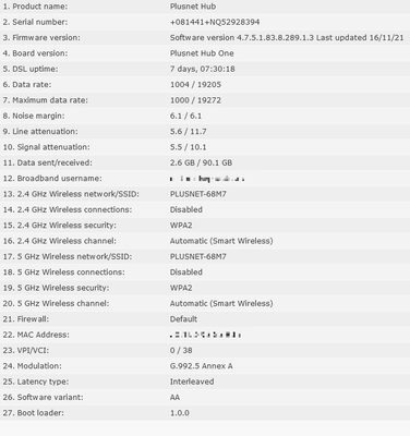

@adamwalker
Sorry for not posting this earlier. Happily it's all looking good here. The router is showing more than 7 days of uptime! Noise margins are stable and low, and the speed is good. I attach a couple of diagnostics. The RouterStatsHub plot shows Tuesday 14th and today (20th) and the drop at the right end is where the computer went to sleep.
Thanks for all the help.
